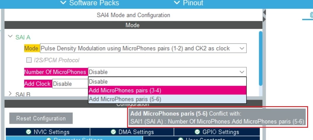

I would like to know how we can configure STM32H7's SAI(s) for 8-PDM microphone inputs (LR * 4 pairs). (16kHz sampling rate).
It seems MX allows us 6 mic with SAI1 and 2 mics with SAI4 but I'm not sure how we can set SAI1/4 exactliy for 8 mics (synchronized data acquisition I want)

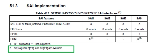

Meanwhile, backing to STM32H742, STM32H743/753 and STM32H750 Reference Manual > 51.3 SAI implementation, Table 417. STM32H743/753/745/755/747/757 SAI interfaces, there is a note indicating that SAI1 & SAI4 instances have only up to 3 D input signals. So, these SAI instances can connect up to 6 microphones:
In order to use 8-PDM microphones, you can configure two SAI in PDM mode (One with 6 mic, one with 2).

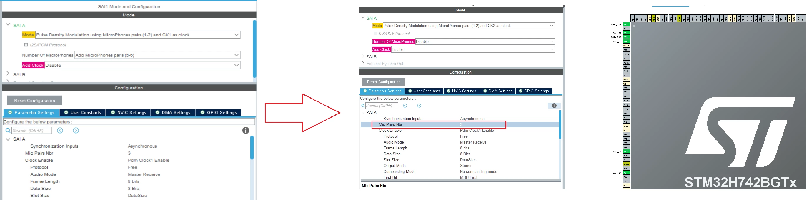

Moreover, a faulty number of microphone pairs will be displayed by STM32CubeMX in SAI4 Configuration Panel > Parameter Settings window tab > SAI A > Mic Pairs Nbr (3 instead of 1), when configuring SAI1-A to "PDM using Microphones pairs(1-2) and CK1 as clock" with a maximum number of Microphones pairs (5-6):
This error in the CubeMX tool will be reported internally to be fixed. I'll keep you posted with the updates.
