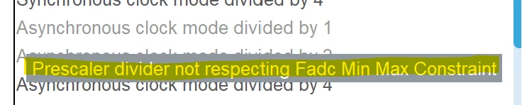

I'm trying to figure out the clock config for my micro. I'm using ADC3 IN1 currently, and using the internal HSI clock source. Using the default settings, I can't seem to get anything better than 3.3 MSPS, and this is with a 10-Bit ADC resolution. From what I read, I should be able to get around 4 to 5 MSPS!
However, that's assuming the ADC is clocked at 60 MHz. By defualt, the ADC clock is divided by 4, so the resulting clock is at 42.5 MHz. Okay! So, I just need to change the divider ratio/or clock it to the PLLP to fix this.
However, I can't figure out a good way to get the prescaler to be okay with an async clock mode with a divider less than 4.
I've tried changing the PLLP clock divider ratio down to 6, which gives the ADC a clock of 56.666667. Won't let me change the prescaler still, stuck at async divide by 4.
Tried a PLLP clock divider of 5, which gives 68 MHz. Still can't change it to lower than 4.
And changing the PLLP clock DOES impact my performance; I can change my trigger timer value and see my maximum sample speed change. If I manually change this line of code,
hadc3.Init.ClockPrescaler = ADC_CLOCK_ASYNC_DIV4;
to lower divider values, it works as expected, and I get the higher sampling rates I want.
Why is CubeMX throwing a fit about this?

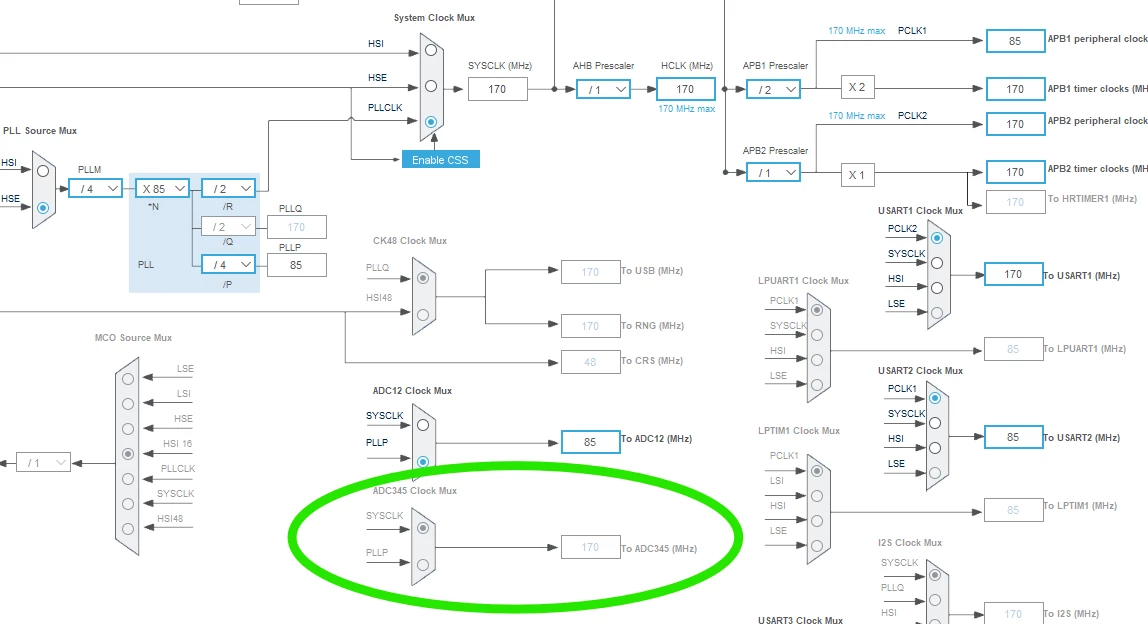

Hover over the grayed out selection to understand the error.
In this case, it looks like CubeMX is using SYSCLK to determine this constraint regardless of the setting of the ADC345 clock mux.

Hello @Jbin0101
After investigating the situation, I found that @TDK  is right about the fact that CubeMX is using the SYSCLK.
The issue is now raised internally for further analysis (170481: this is an internal ticket reference)
In the mean while you can change the divider value manually in the generated code to suite your need.

ADC345 Clock Mux cannot be changedADC345 Clock Mux cannot be changed
July 31, 2024
This is not the same issue as the OP.
To change the ADC345 mux, you first need to enable one of those ADCs. If that doesn't work, open up a new thread with relevant information and attach the IOC file.
