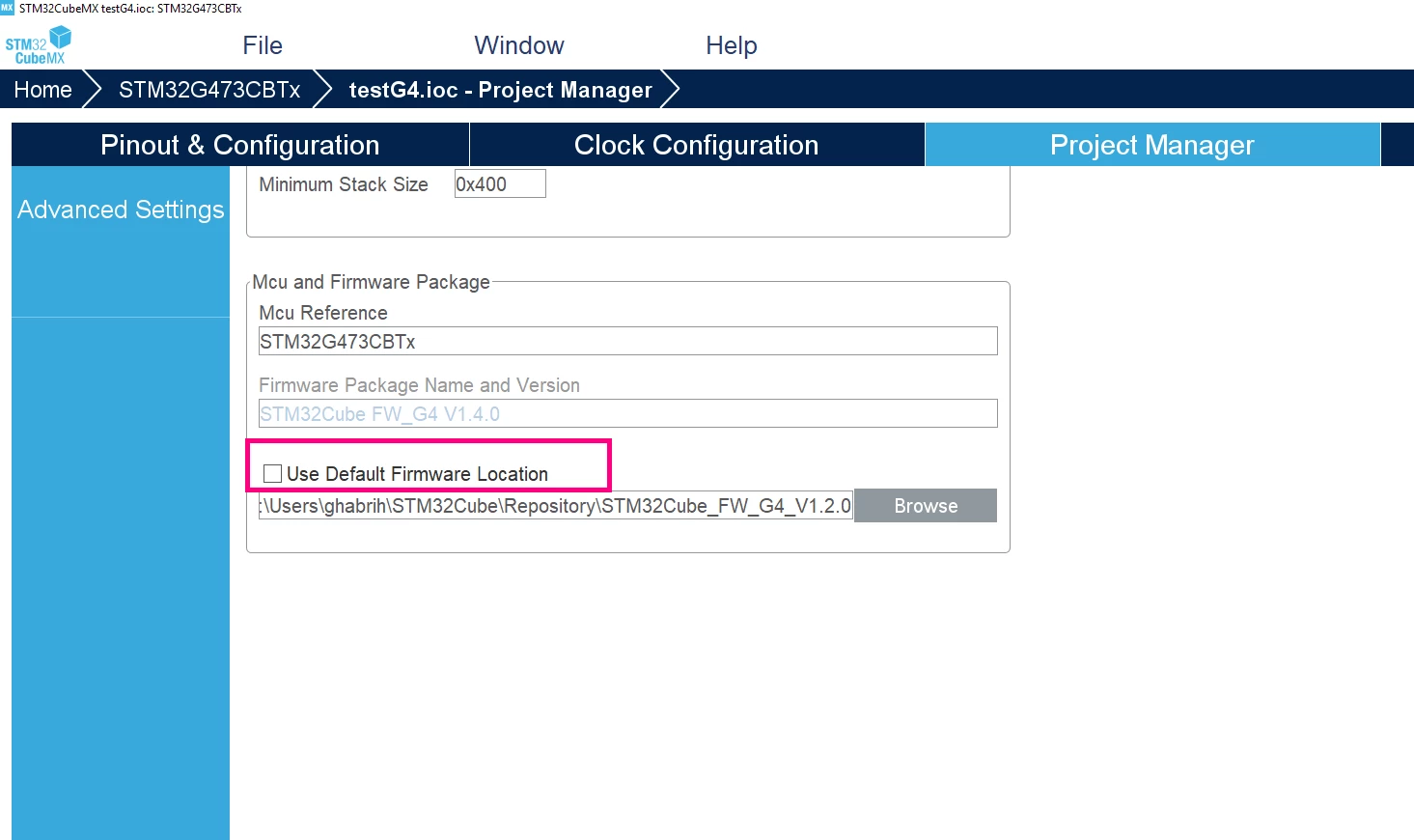

STM32G474 OPAMP configuration Bug
Are there any plans to repair the CubeMX system and to re-enable the configurations of STM32G4 firmware version 1.2.0? I tried version 1.3.0 and 1.4.0, and both don't allow to configure an OPAMP as follows:
hopamp5.Instance = OPAMP5;
hopamp5.Init.PowerMode = OPAMP_POWERMODE_NORMAL;
hopamp5.Init.Mode = OPAMP_PGA_MODE;
hopamp5.Init.NonInvertingInput = OPAMP_NONINVERTINGINPUT_IO2;
hopamp5.Init.InternalOutput = ENABLE;
hopamp5.Init.TimerControlledMuxmode = OPAMP_TIMERCONTROLLEDMUXMODE_DISABLE;
hopamp5.Init.PgaConnect = OPAMP_PGA_CONNECT_INVERTINGINPUT_NO;
hopamp5.Init.PgaGain = OPAMP_PGA_GAIN_32_OR_MINUS_31;
hopamp5.Init.UserTrimming = OPAMP_TRIMMING_FACTORY;
This was generated with CubeMX version 5.6.1 and STM32G4 firmware version 1.2.0. I am using this in an actual project and because of the bugs in 1.3.0 and 1.4.0 can't change to newer versions.
