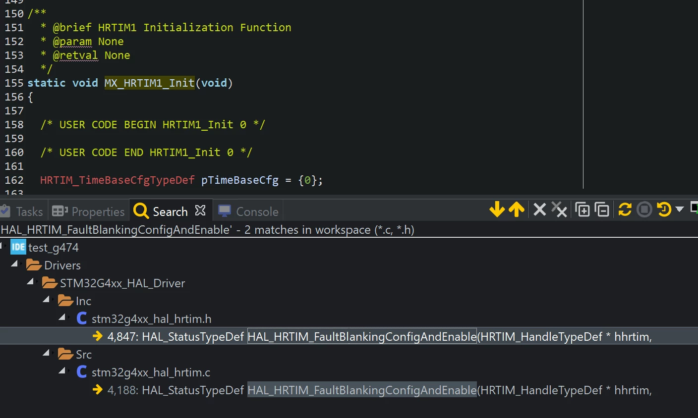

I'm using HRTIM in STM32G474 device in STM32cubeIDE and can't find a way to not get a call to HAL_HRTIM_FaultBlankingConfigAndEnable() function in initialisation, that enables blanking by default. I don't want blanking for FAULT inputs, but IDE (or CubeMX) doesn't offer an option to disable blanking (or I just can't find it).
Thank you for your suggestions in advance.
Regards

I just made a new project, enabled HRTIM, and get no such call to HAL_HRTIM_FaultBlankingConfigAndEnable() in initialization. Maybe you can share IOC file.

Hello TDK,
thank you for your reply and help.
I attached .ioc file.
Did you enable fault inputs? Because, I need fault inputs functionality, but without blanking.
For now I use workaround by calling __HAL_HRTIM_FAULT_BLANKING_DISABLE(&hhrtim1,HRTIM_FAULT_1) macro to disable blanking before starting of HRTIM outputs, it looks ok but I must test on hardware to be sure.
I just can't find a way in CubeMX to configure that.
