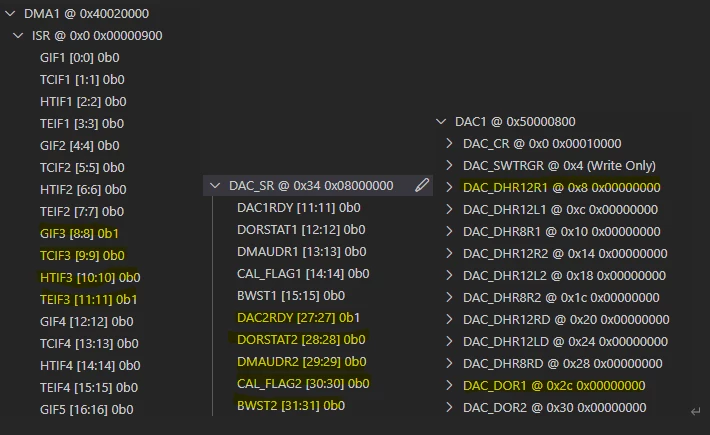

STM32G474 DMA cannot write to DAC_DHRx register
Hi everyone,
I am using the NUCLEO-G474RE development board with STM32G474RE MCU
The ioc file is attached, and this is main function:

​I use TIM6 to generate a periodic DMA request and use it to send waveform data to "DAC_DHRx", but the DMA generates a transfer error (DMA TEIF flag is 1).
0693W00000Ly1LTQAZ.pngWhen I reset the DMA direction to "Peripheral to Memory" in CubeMX, DAC_DHRx can be sent to memory.
Besides that, I have ported this program to STM32L476G-DISCO and it also works fine.
What setting am I missing?

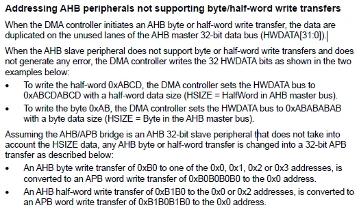

I solved the problem, I found the following information in the reference manual 12.4.6:
0693W00000Ly3d0QAB.pngAHB peripherals not supporting byte/half-word write transfers, so I change the data width to word, and it works fine.

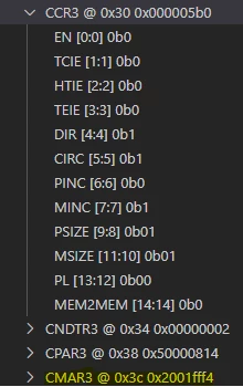

Is Data in a DMA-accessible location? Print out the DMA stream register information.
Shen
ShenAuthor
Apr 15, 2022 12:46 AM UTC
Hi TDK,
Thank you for your reply, and here is my DMA setup:
0693W00000Ly3S7QAJ.png​It should be the DMA accessible location
