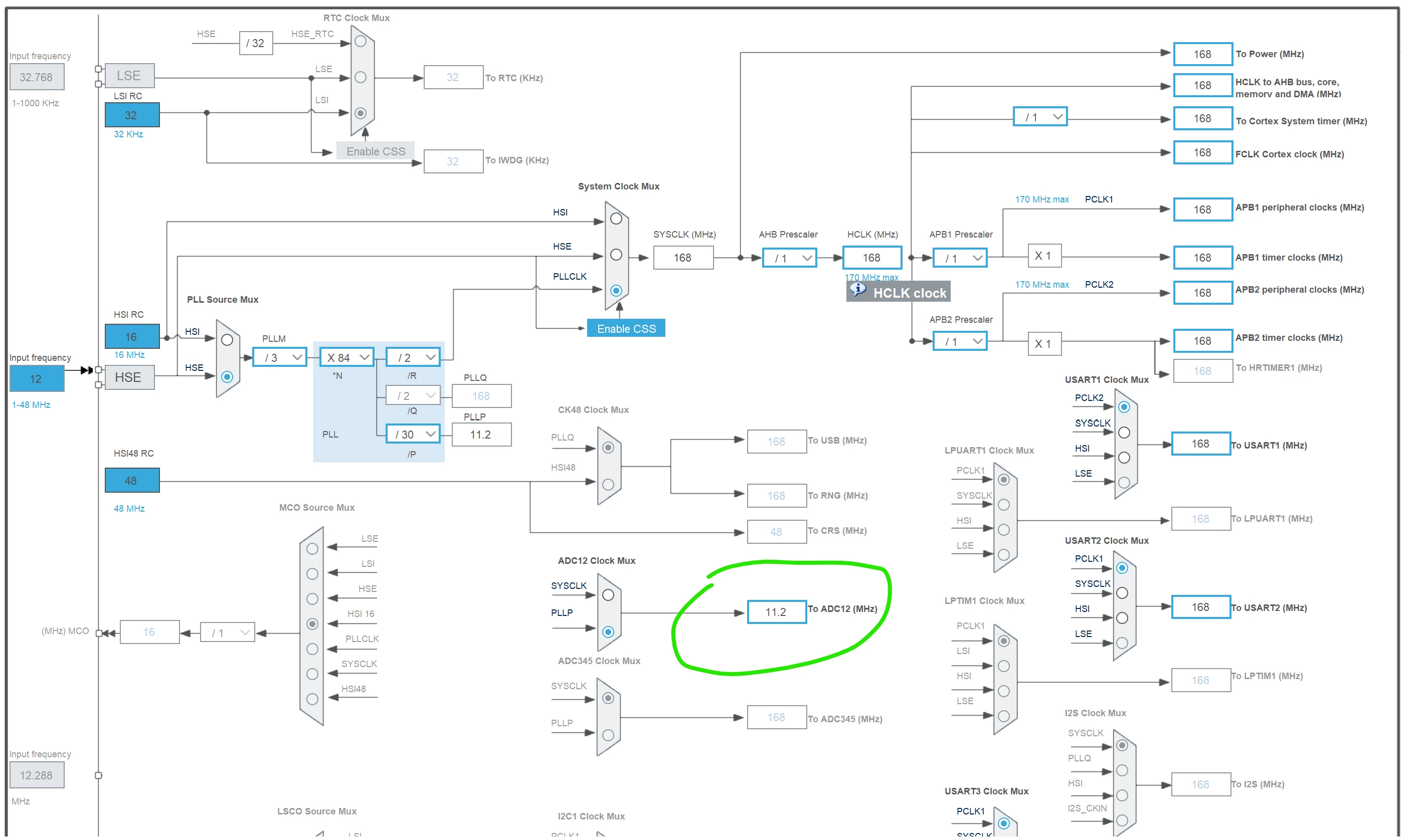

STM32G473 ADC - can't select asynchronous clock divider 1 or 2, even with low clock frequency
I'm using STM32G473 ADC and trying to feed its clock from the PLL P clock. I am not able to select a clock divider of 1 or 2 even when the PLL P clock is set rather low (11.2 Mhz). This is my clock configuration:

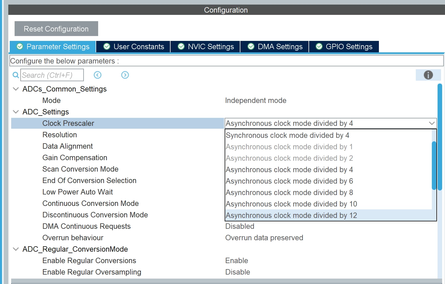

This shows CubeMx not allowing an async clock with divider of 1 or 2, only 4 and higher:

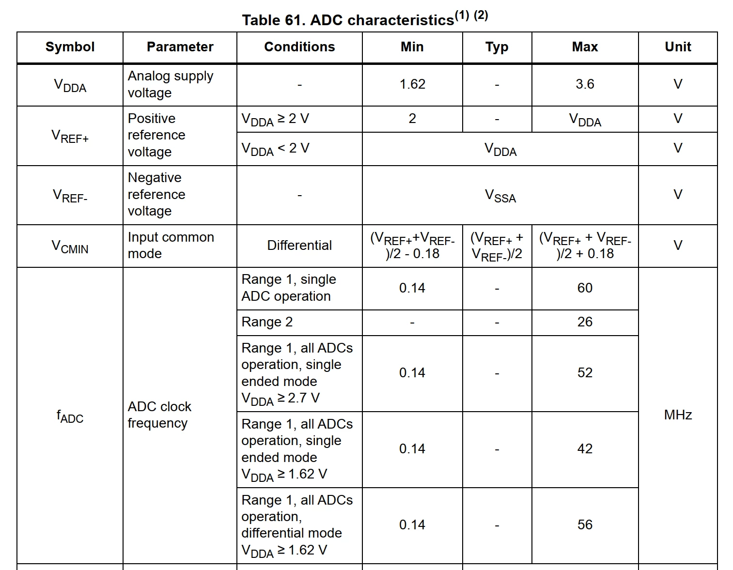

For reference, these are the frequency limits of the ADC from the datasheet:
Specifically, I'm at the 52 MHz max spec (single ended, multiple ADC's) but whatever CubeMX thinks my limit is, I'm not sure why I can't divide-by-1 a 11.2MHz clock!

tinkerer42
August 27, 2024
OK, I fiddled with the settings some more and discovered another thing: If I enable only ADC1 and ADC2 (or just ADC1) then I can select my prescaler as expected. However, if I enable ADC3 as well, then I can't select /1 or /2, only /4 or higher, as noted in my original post.
I can't find a reference to this limit in the datasheet. Why is that?
