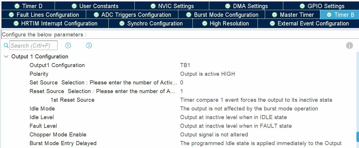

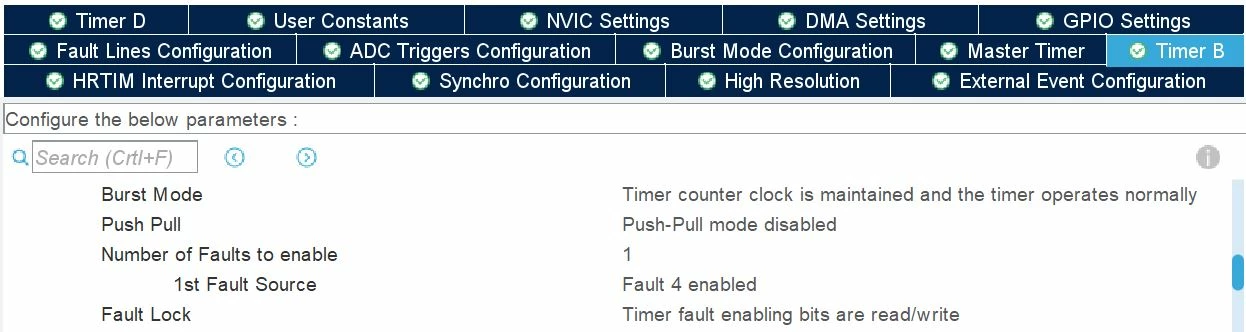

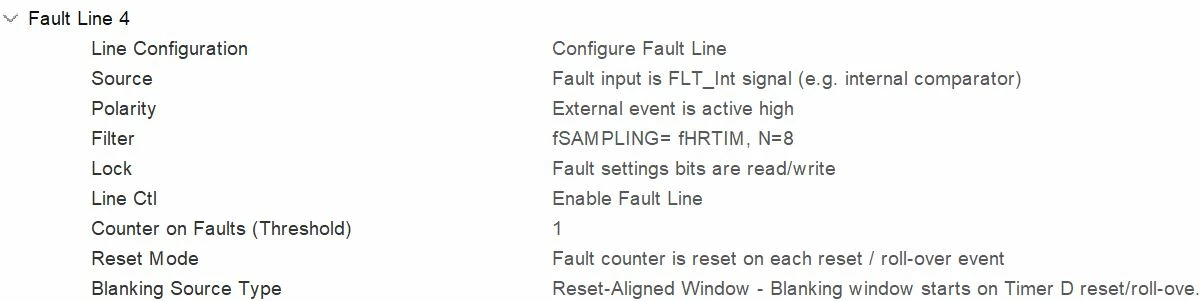

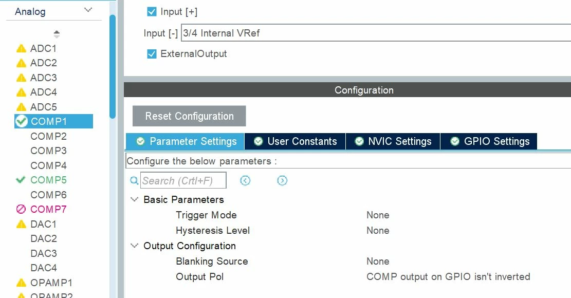

STM32G4 comparator output can‘t disable the PWM outputs when I want to use the fault protection mechanism。Is there something wrong in STM32CubeIDE configuration?
  • May 14, 2021
  • 1 reply
  • 1636 views
0693W00000AOITxQAP.jpg0693W00000AOITsQAP.jpg0693W00000AOITiQAP.jpg0693W00000AOITYQA5.jpgI tried to do a lot of changes of configuration,but it didn’t work. when I use comparator output as FLT input pin,fault protection works,however it‘s used as FLT_Int signal,it always doesn’t work.
Hope your kind help,Thanks!

Hello
I think you have to fill the "Trigger Mode" of your comparator with an Event (and not an interrupt) :
