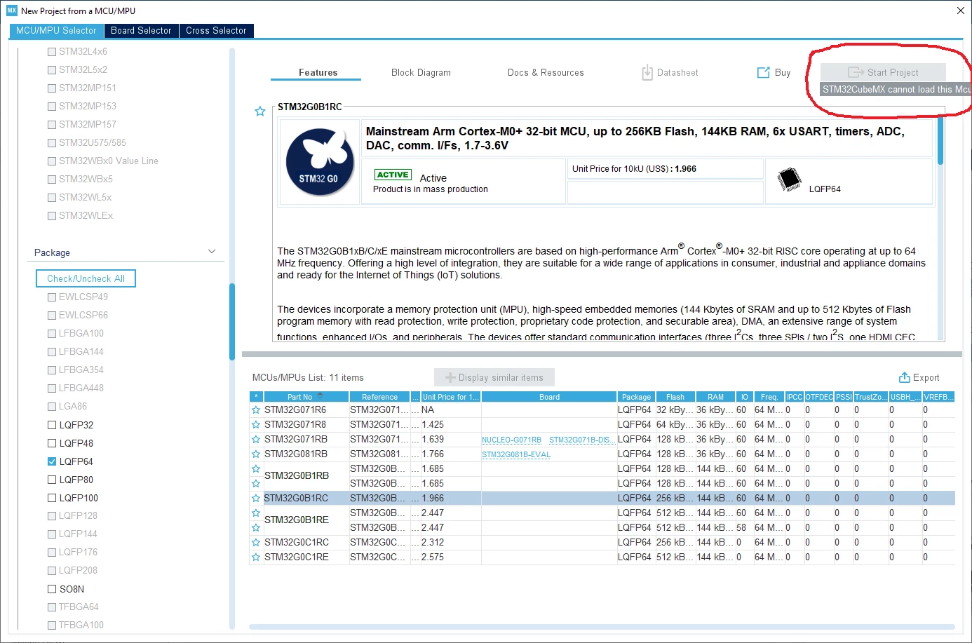

STM32G0B1RC : 'STM32CubeMX cannot load this Mcu' - When will it be fully available?
I tried to create a new project with STM32G0B1RC using CubeMX, but the button 'Start Project' is disabled. When I mouse over the message 'STM32CubeMX cannot load this Mcu'' is displayed:
In a similar thread regarding this message I read about the MCU being in preview mode, but not yet supported by HAL and CubeMX.
Could you please provide a date, when full availability of STM32G0B1RC is planned?
Thanks in advance for any support.
Best regards,
Hendrik

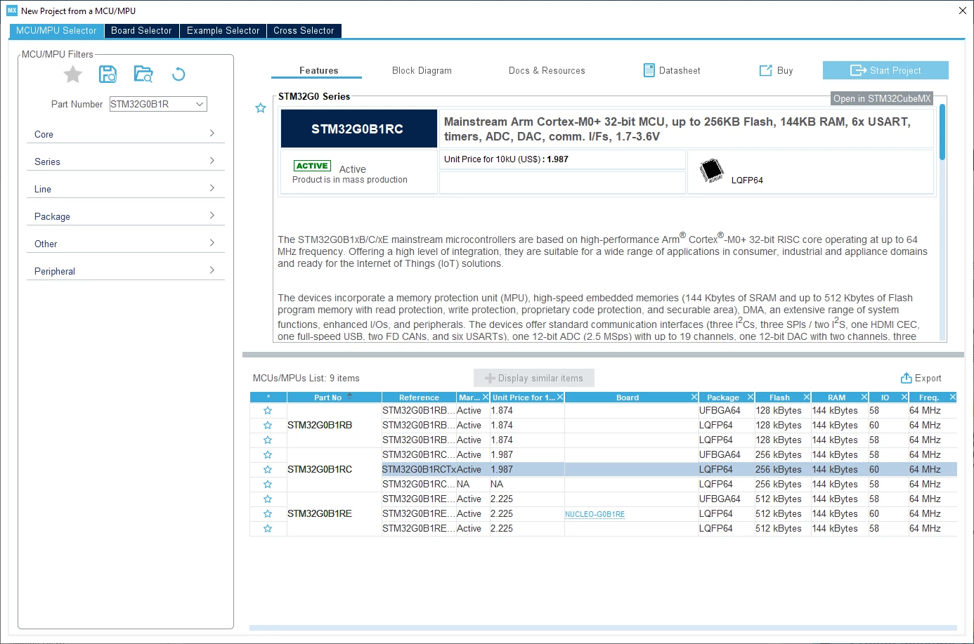

HMaye.1
HMaye.1Author
Nov 22, 2021 10:59 AM UTC
Version 6.3.0 has resolved the issue for me.
Side note:
I first had to update to a previous version (6.1.2), before an update to 6.3.0 was possible in STM32CubeMX Update Manager. I hope this hint helps others.

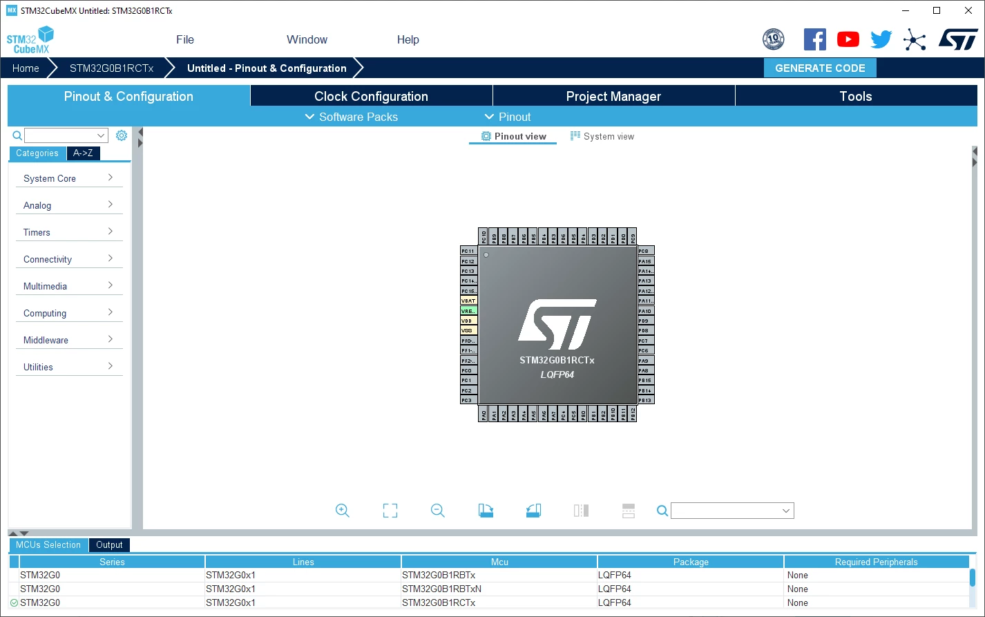

After the update 'Start Project' button was available again and a project with STM32G0B1RC could be successfully created:
Thanks a lot!
