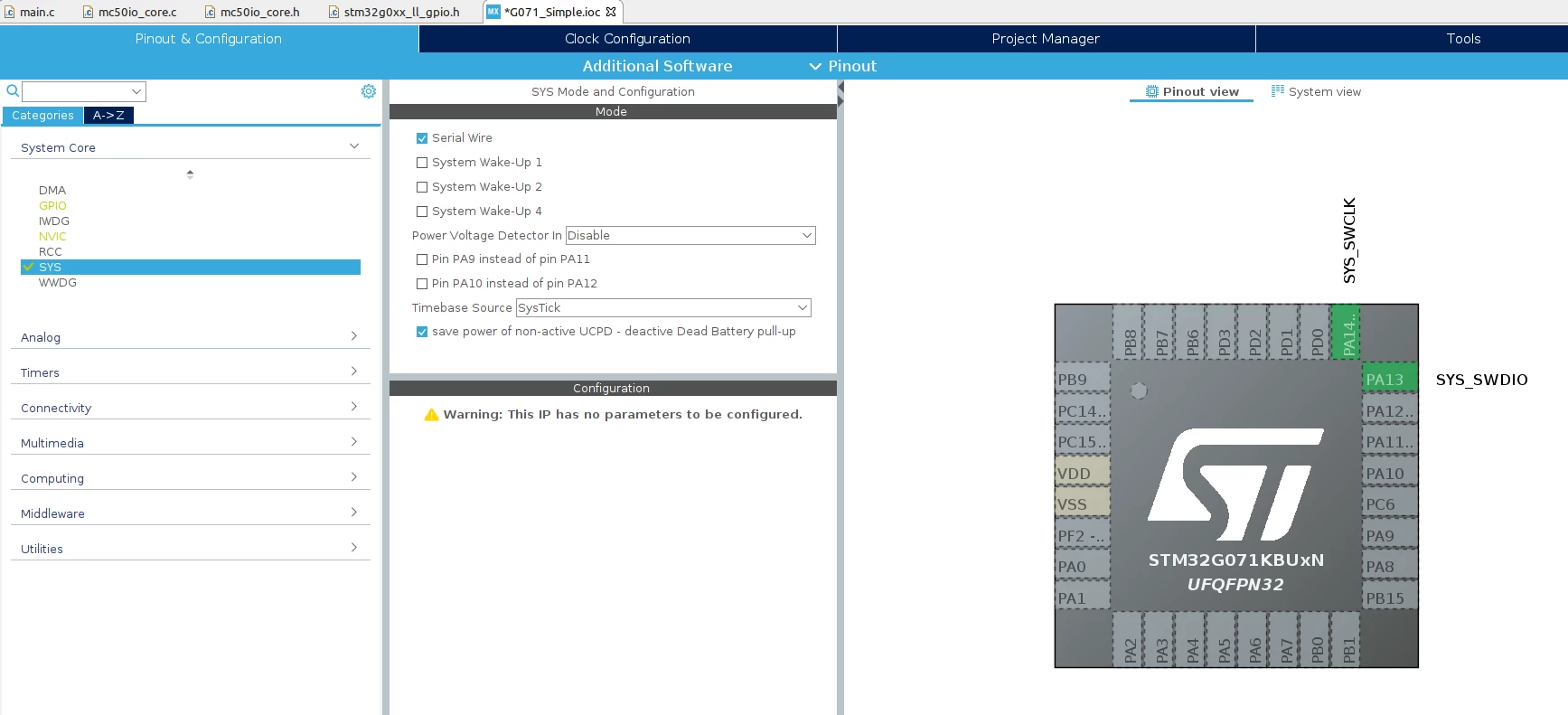

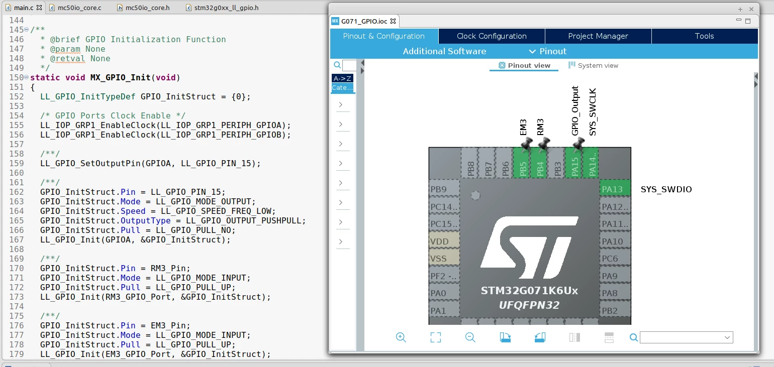

Last I generated a simple (KISS) project called just simple to test problem & share here: surprise :( ####@@@@@!!! :(v :thumbs_down:
No PA15 but PD0, NO PB4, NO PB5 Instead of them PD 2 PD2...
AAAAAARGH!!!! Another day and half lost across defective software ...

KISS version just after I got surprise on:
And welcome to HELL:

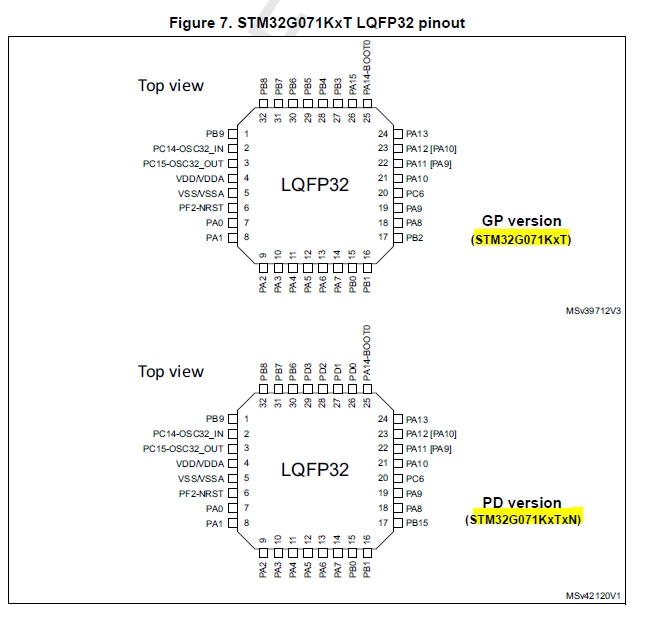

Hello rromano001,
According to the screenshots attached you are using two different versions of STM32G071KxT LQFP32 MCUs: STM32G071KBUxN (PD version) and STM32G071K6Ux (GP version). Each version has its own pinouts.
So I don't think it is an IDE error.
Please refer to STM32G071x8/xB DS for further information (https://www.st.com/resource/en/datasheet/stm32g071c8.pdf).
