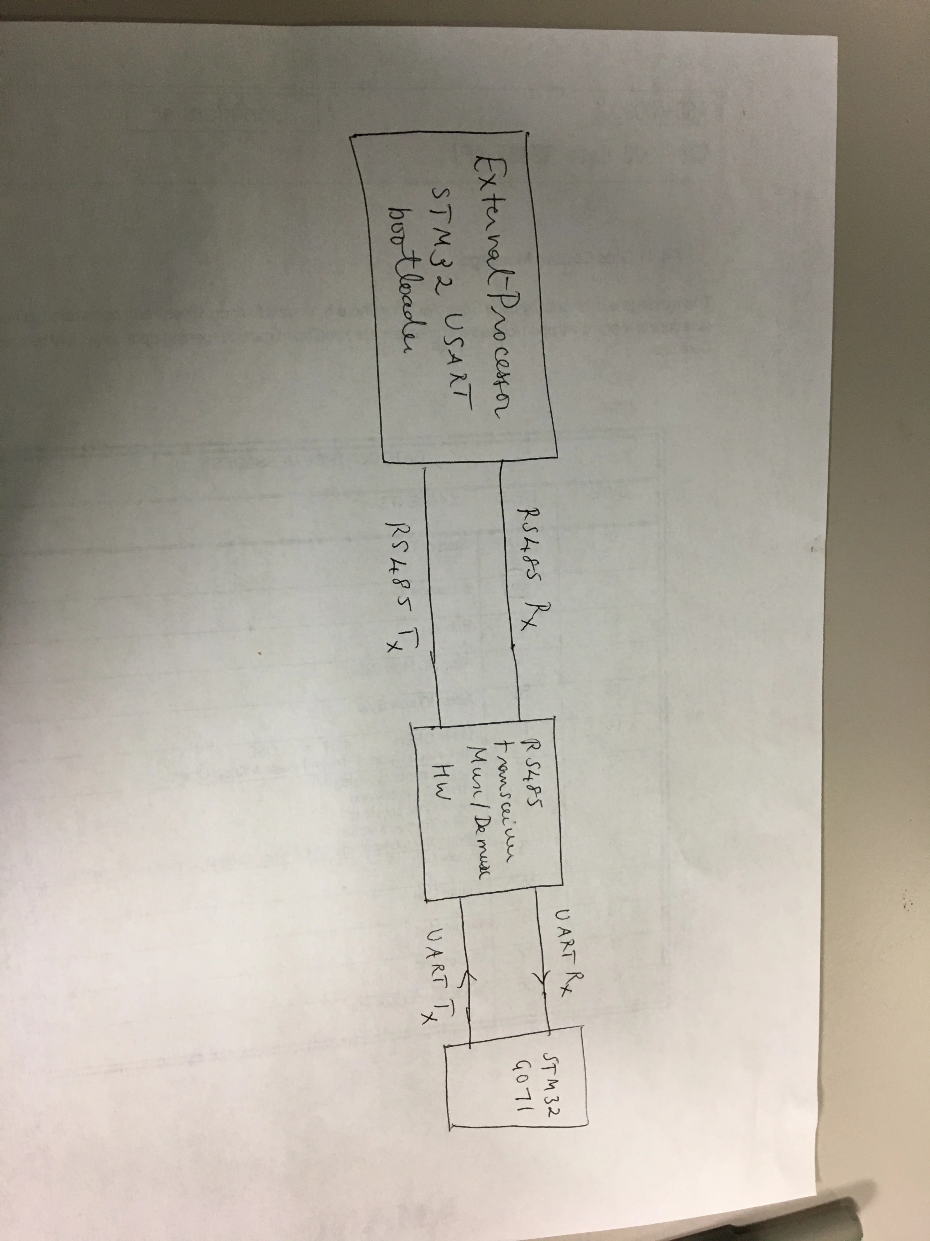

thank you for your replies. I have attached a picture of a possible bootloader connection. Is this likely to also be noise prone?
If it will be, I will post again with a follow up question.

If it's repeatable, it's probably not noise. RS485 is quite tolerant of noise since it's a differential signal, as long as it's wired correctly. You should have external pullups on the UART lines. Length of wires will also matter, which can't be determined from a schematic.
Regardless, I don't think noise would even explain the results you're seeing. A software bug does.

Thank you. UART to RS-485 HW on the PCB will all be layout connections, no cables. RS485 Cable comes in only to connect to the external processor.
Sep 21, 2020 2:11 PM UTC
I confused this post with another one. Ignore most of my last post, except that RS485 is very tolerant of noise.
