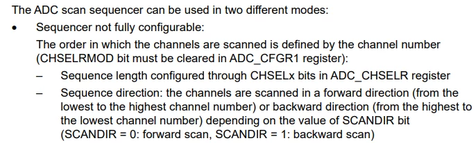

Best answer by PieterInHetBos
You are proberly still in normal mode and not in legacy mode.
If you configer the ADC to "not fully configurable" you can use ADC_IN15&16&17

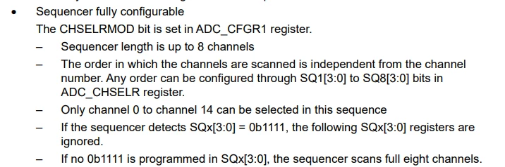

The centre panel-ADC mode and configuration, shows ADC configuration with IN15 to IN18 grey out ???
BTW, Vsense is IN12, Vrefint is IN13 and Vbat/3 is IN14 though which are not exposed in the centre panel.

PieterInHetBos
April 19, 2023
No problem
Took me a while to find it! hope it helps you and more people!
!!Source RM0454 section 14.3.8 page 284 and 285
--Not fully configurable--

Chan.Calvin
April 19, 2023
By the way, a newly created project should have the default of 0 for CHSELRMOD bit if not explicitly configured, which means the default is "Sequencer not fully configurable" and should have the green for both PB11 & PB12 though. But this is not the case.
