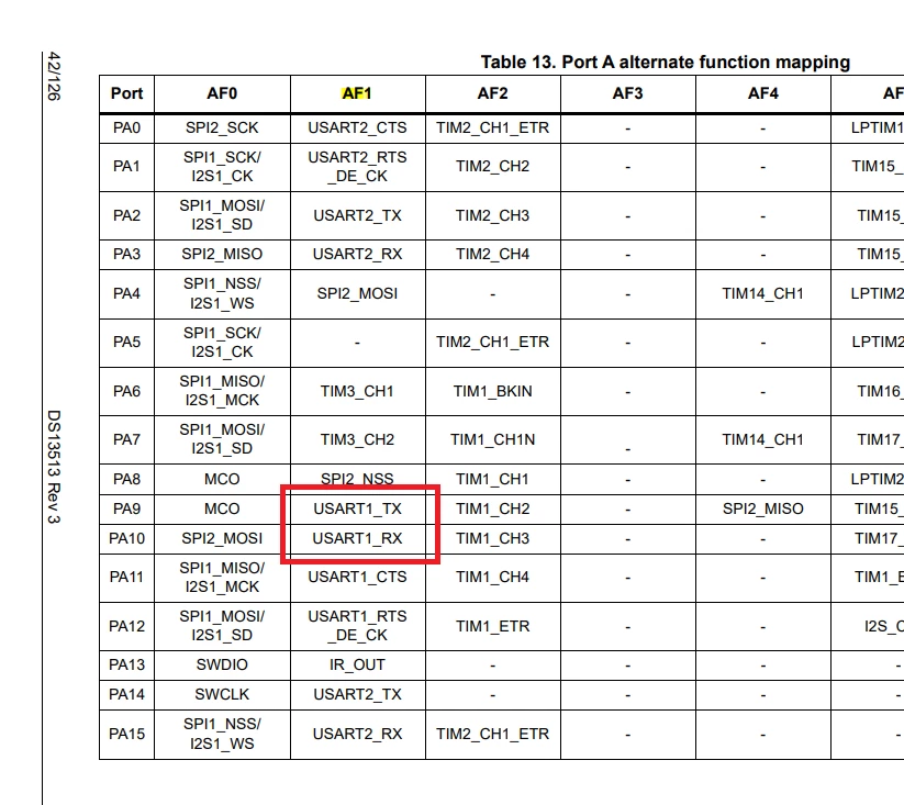

If you enable USART1 in asynchronous mode for pins PA9 and PA10 the auto generated code incorrectly sets the port to AF0 when it should be AF1 see datasheet table 13 or port.png.

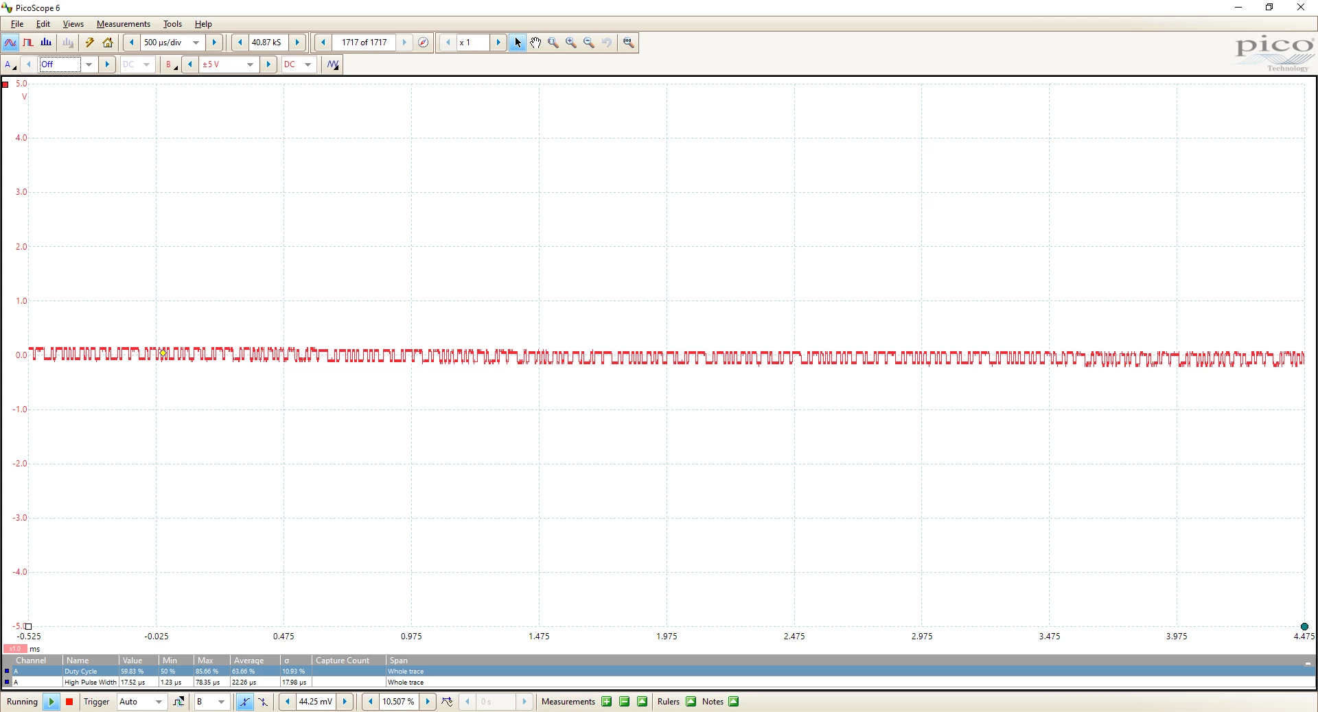

When set to the correct port it transmits but at very low amplitude of a few mv. See scpoe.png

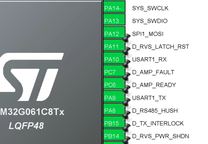

STM32G061C8U6, that's the UFQFPN 48
Make sure the PA11/PA12 (USB) usage of these pins is deconflicted

June 10, 2022
I have these configured as GPIO outputs and these work as expected.
I tried creating a brand new project with just UART1 enabled and I get the same behaviour.
Under the SYS menu Use PA9 instead of PA11 and PA10 instead of PA12 is disabled.
Read out and check/post relevant GPIO and SYSCFG registers content.
What hardware is this? Did you measure directly on the pin? Isn't there a bad solder joint? Isn't there something else connected to this pin?
