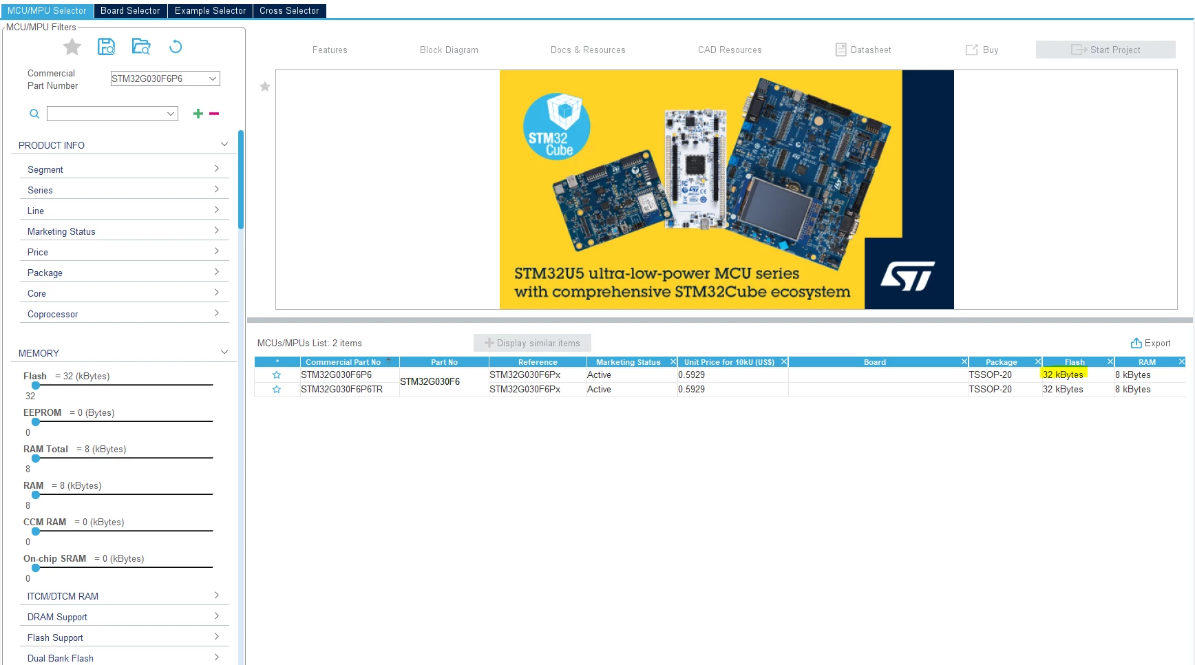

I'm creating a new project for STM32G030F6P6 in STM32CubeMX. It says 32 kBytes flash.

The data sheet says this MCU shall have 32kByte flash but it works as a 64kByte. What is going on?

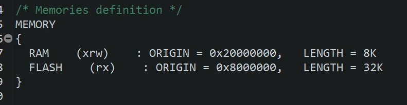

But is is a bit strange that STM32CubeMX generates a linker script to use the whole 64K when it isn't guarantied to work.
The linker script generated for CubeIDE shows 32kB here. Probably an IAR-specific issue.
MSipo
MSipoAuthor
Senior II
Yes. if I generate an STM32CubeIDE project the STM32G030F6PX_FLASH.ld is correct. But when I select EWARM project the stm32g030xx_flash.icf is incorrect.
I hope ST fixes this. This could suddenly break firmware.
