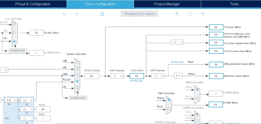

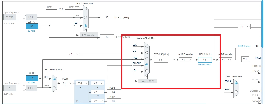

I have NUCLEO-G071RB board . How to calculate 1KHz frequency with STM32G071 Output compare ?
My System Clock frequency is 64 MHz .

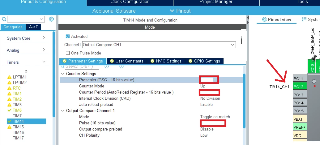

timer frequency = (timer clock) / (PSC + 1) / (ARR + 1)
PSC is "Prescaler", ARR is "Period"
So for a 64 MHz timer:
prescaler=63
period=999
And for 50% duty cycle, set pulse = (ARR + 1) / 2 = 500.

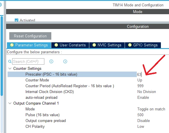

Thanks... But...
These calculation gives 500Hz instead of 1KHz on Digital Storage Oscilloscope.
F = 64/(63 + 1) /999 + 1 ;
F = 1/1000 ;
T = 1000
While below calculation gives 1KHz.
prescaler = 63 ;
period = 499 ;
pulse = 499 ;
Why so ?

It is simle. In one timer period comes one Compare event. If you toggle output on compare event you have one toggle per (timer) period. To generate square wave you need two toggles (rising edge and falling edge). Whole period of your waveform takes two periods of timer. TDK suggest you both situations that you are describing (probably because your question was unclear - asking for 1kHz square wave or 1kHz Copmare events).
Jan 17, 2021 3:34 PM UTC
> Why so ?
You have toggle on match mode. Set it to PWM mode, or double the frequency.
