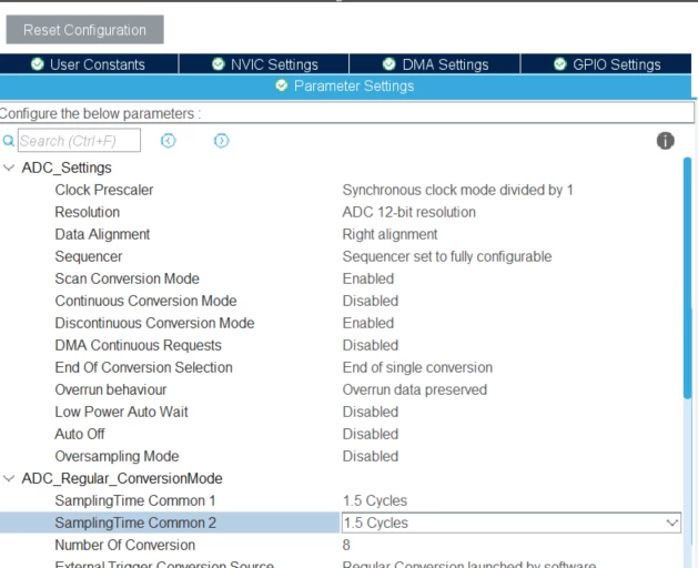

Hello everybody,
i am using STM32G071RBTX and stm32cubide, using ADC1 for 10 analog pins and i nead to start conversions and read value of them one by one.
my problem is there are 10 analog pins which means 10 channels but i do not know how can i read them while there is just 8 number of conversions.
can anyone give me any clues?

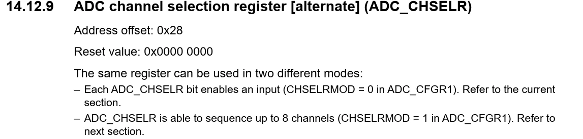

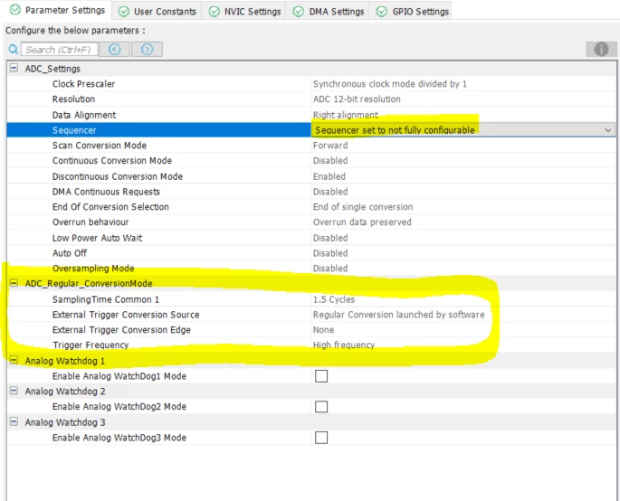

    from rm :
    so set > Sequencer -> not fully conf. ...
    then can set all channels, not only up to 8 in sequence.
    shishiAuthor
    July 5, 2023

    One method - in Cube MX configure the two pins to analog and regenerate the code for CubeIDE.
    Second method - edit the ADC initialization code to 10 NumberOf Conversions, add the channel configuration code for the two channels, and increase the size of the conversion results buffer.
    shishiAuthor
    July 5, 2023
    method one: i already configured for 10 analog pins.. i can not undrestand why should i configure it for 2 pins???
    Second metod: it is not possible because the maximum amount of conversions is 8

    July 6, 2023
    You can't sequence all 10 channels at once. You'll need to set it up to convert only 1 channel (CHSELRMOD=0) and change that channel after each conversion is complete.
