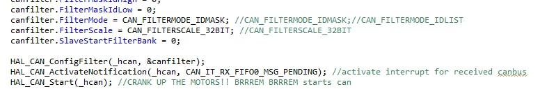

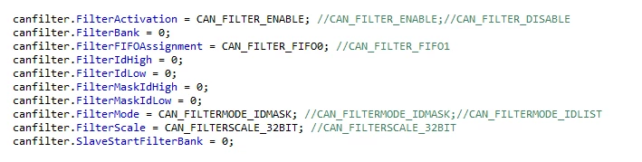

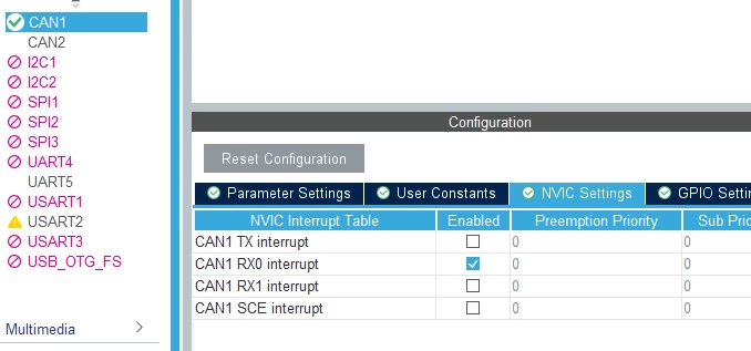

Not saying thats your problem but i do it in this order.(different mcu but maybe it helps you)
 0693W00000YAudFQAT.png0693W00000YAuc7QAD.pngAnd the
HAL_NVIC_SetPriority(CAN1_RX0_IRQn, 1, 0);
HAL_NVIC_EnableIRQ(CAN1_RX0_IRQn);
part
Is already deatl by cubeMX when i tick the interruption generation button.
