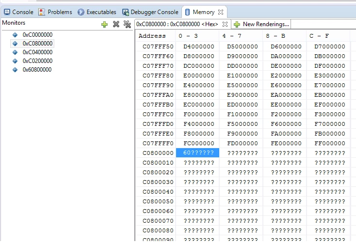

Nov 8, 2020 11:10 AM UTC
Hi FGeig.1 !
Yes, when I write data into the SDRAM, read out and compare, then I get a 1:1 match.
After attempt to write above 0xC080 0000 I get a HW fault.

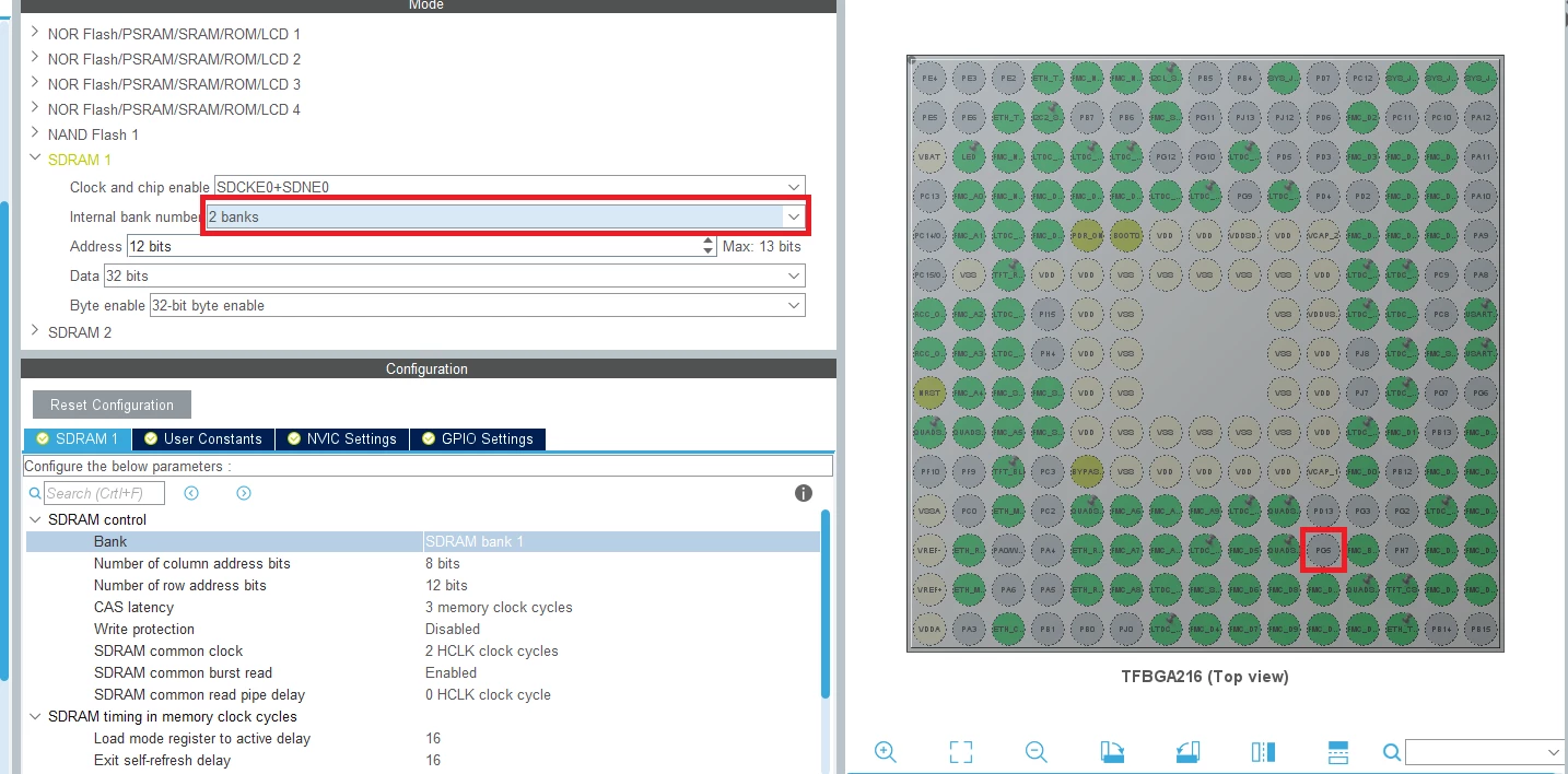

Now I have tried to reduce the configuration to 2 banks and the result is the same:
When do this, then the BA1 pin (PG5) is deconfigured in the pin overview:
In the configuration of the fmc.c I can see the bank pins:

FGeig.1
FGeig.1Author
Nov 8, 2020 12:39 PM UTC
I think this is fine, all the memory allocation is taken care of by the FMC and it clearly works for 2 out of 4 memory banks.

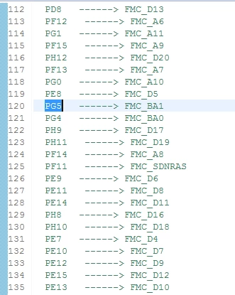

So I did some tests with the PG5 pin (BA1).
If I declare it as a GPIO and set to High/Low, then it responds correctly, i.e. will set to 3.3V or 0V. this means that there is no short circuit on the board.
If the connection between the CPU and SDRAM on that line is ok, I can't tell, because both of the devices are in BGA package and I don't have and access to the pins/vias on the board (buried vias).
I will ask for another HW to try this out (to exclude a PCB issue), but I still think that this has something to do with a wrong initialization...
