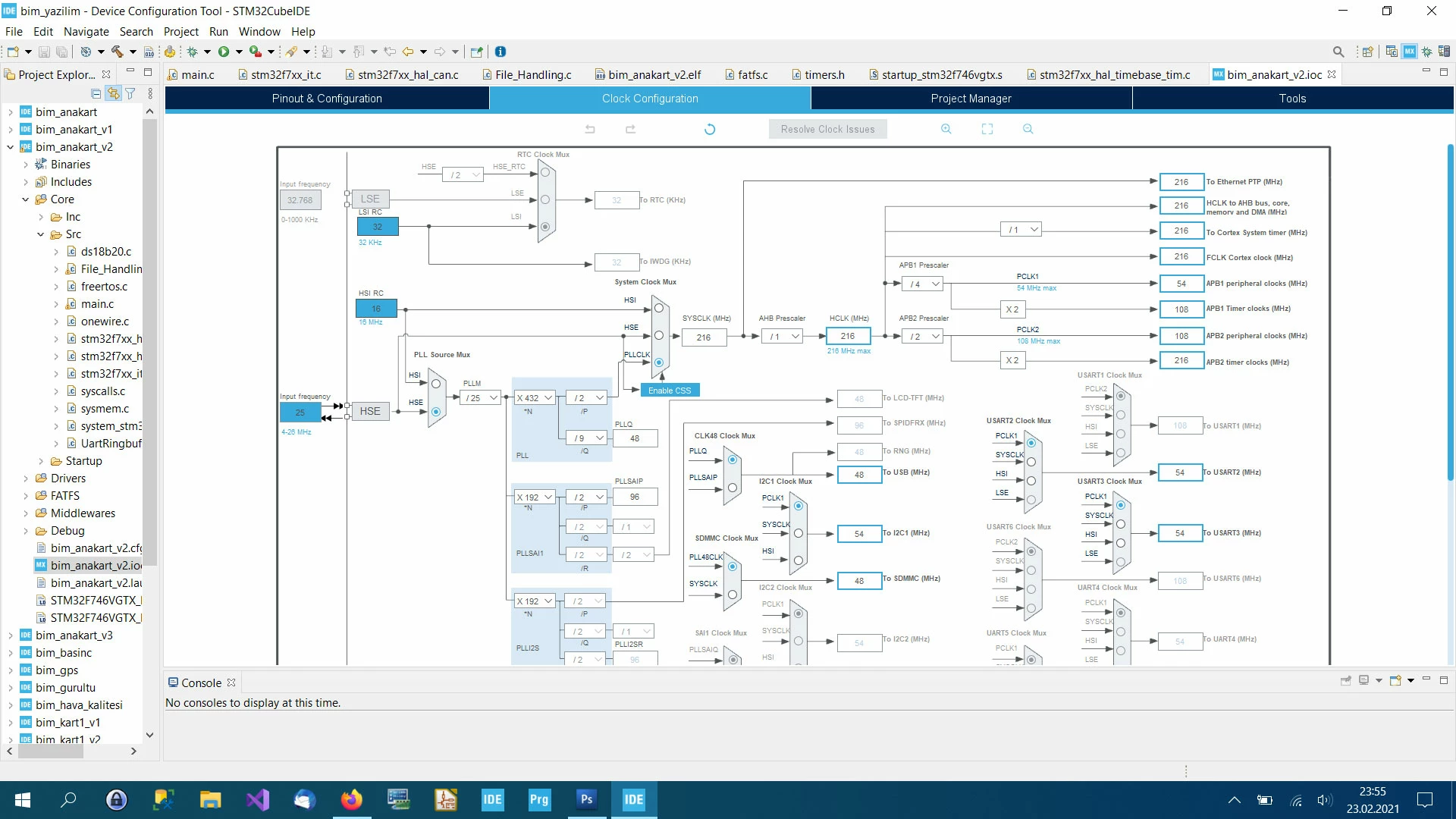

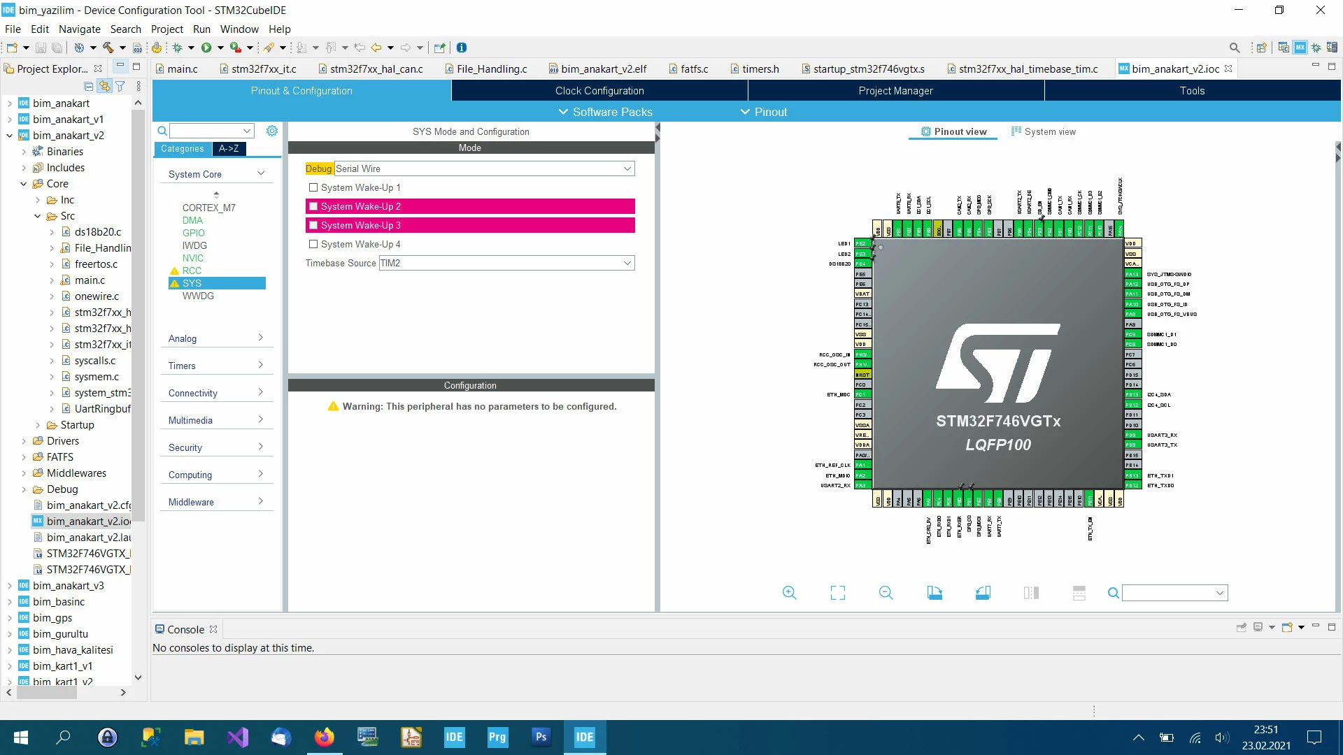

0693W000007ZHBEQA4.jpg0693W000007ZHB4QAO.jpg0693W000007ZH9wQAG.jpgfriends, I have a problem, can you help? I am working with the stm32f746vgt6 microcontroller. I came across something that had never happened to me before. I am using freertos. My crystal frequency is 25 Mhz. Whenever I select the sys timebase source as a source, the microcontroller cannot start, it constantly dials tim interup. but the microcontroller ends in the reset printing process. Has anyone been seen before?

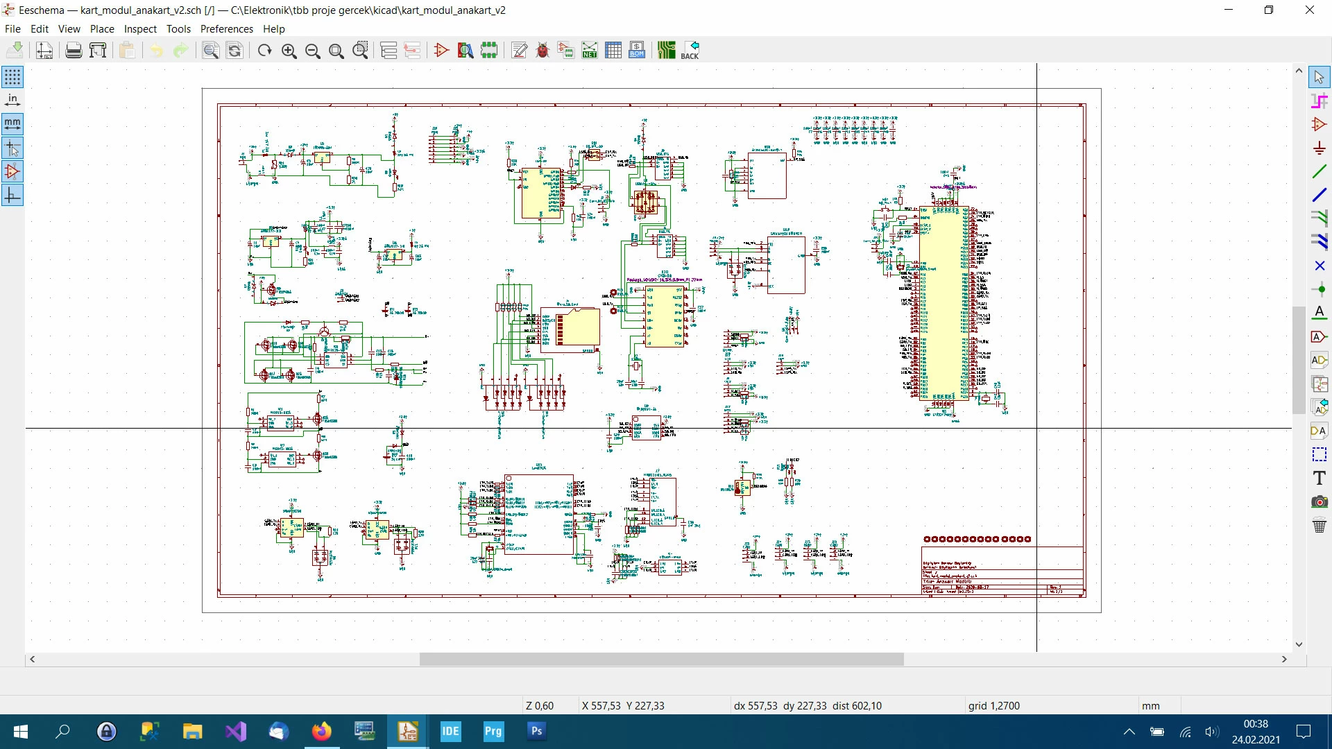

@Community member​ e0693W000007ZHMMQA4.jpgmy pcb schematics.the system does not fail. it starts normally when reset is pressed. as if not booting, but it does.

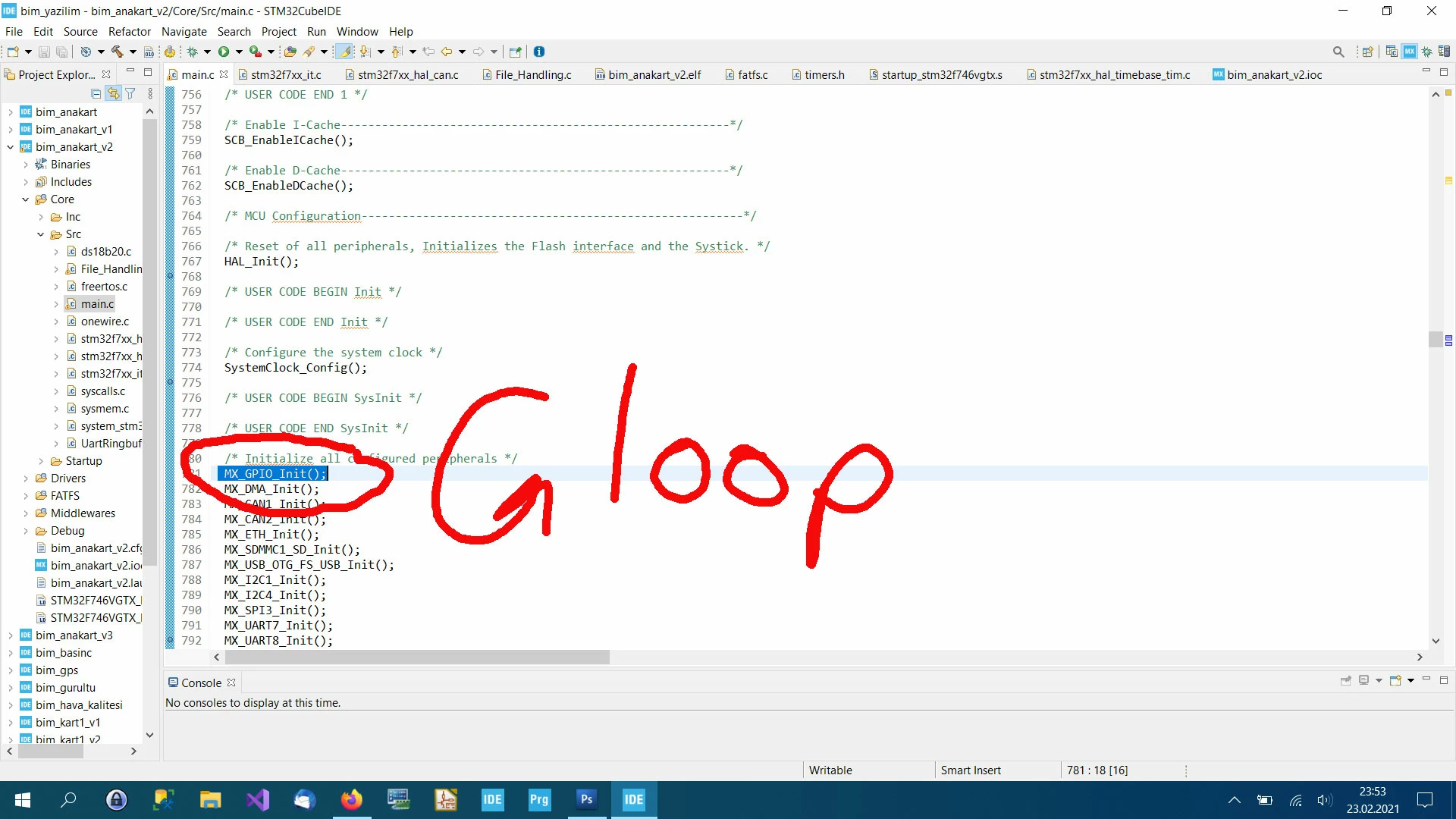

If it dies in the highlighted routine, use the debugger, step into it and follow it to the point of failure.
If it is stuck in a TIM interrupt that would be because you aren't servicing it properly, and it will keep firing until you do.
Check the peripherals register, understand what is flagging, and why you enable it, but fail to deal with it in the IRQHandler.
