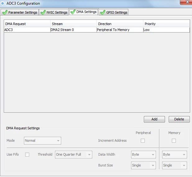

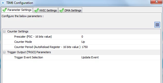

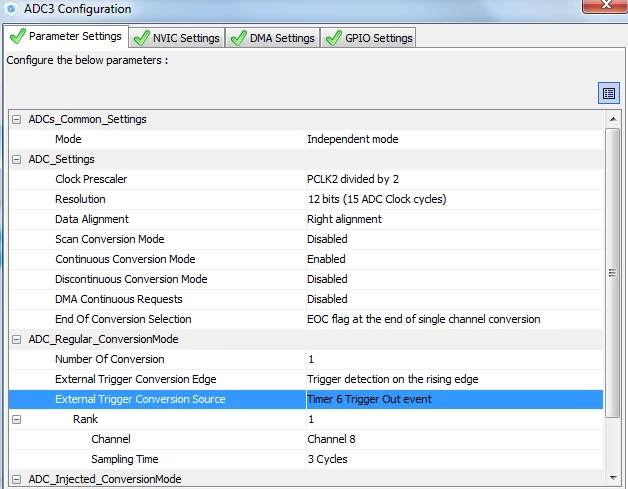

Hello all,
I have configured the ADC to trigger based on Timer 6 update event every (1/48000) seconds. DMA is used to transfer the ADC conversion to memory. However, when I debug, I see the timer count being incremented, but I don't see any ADC conversion being made or anything in the memory location where it saves the ADC values through DMA. I have used ST's CubeMX to generate the initialization code.

Best answer by sjpatel1992
Posted on August 06, 2015 at 01:04
for anyone with same problem, enabling the DAC clock via __HAL_RCC_DAC_CLK_ENABLE() command before starting the timer solved the issue.

Posted on August 04, 2015 at 15:11
ok, I have narrowed down the problem a bit. The issue lies with the Timer 6 not triggering the ADC.
I guess I could use the timer interrupt to manually trigger the ADC conversion on overflow (1/48000s), but I would rather like to have it trigger automatically. Any suggestions?

There is probably salient code missing for timer configuration. See the ADC Trigger Mode example that comes with the HAL library.

I had no idea there were more examples in the STM32756G_EVAL folder. I was previously only looking under the STM32746G-Discovery folder, and there is only one ADC_regular_conversion_DMA example. T
Anyways, I looked at the main.c file of the ADC_TriggerMode example and found the following differences:
1. Before starting the timer using the HAL_TIM_Base_Start(&htim) function, they have enabled the DAC clock using __HAL_RCC_DAC_CLK_ENABLE();
2. Under the timer configuration, they had MasterConfig.MasterSlaveMode = TIM_MASTERSLAVEMODE_ENABLE, whereas the  initialization code that was generated by CUBEMX has MasterConfig.MasterSlaveMode = TIM_MASTERSLAVEMODE_DISABLE
3. in addition, they have used Timer 2 instead of Timer 6, but that shouldn't really make a difference.
I currently don't have access to the discovery board, but do you think these differences are what's causing timer 6 to not trigger? Thanks for the help.
