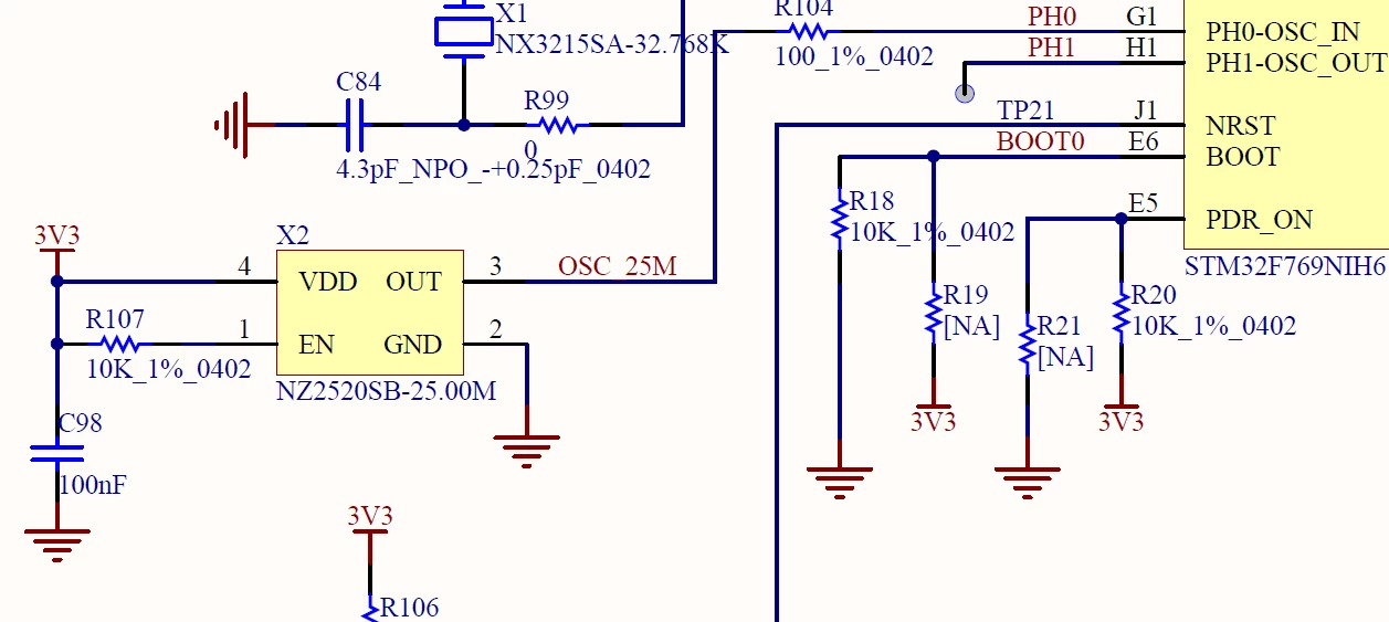

STM32F7 can't use default STM32CubeMX config, can't enable PLL, and can't switch to Over-drive
  • August 7, 2021
  • 1156 views
I'm using STM32CubeMX 6.3.0 with the bundled version of STM32CubeF4
I create a new project by selecting my STM32F769I-DISCO board and letting Cube initialize all peripherals to their default modes. I generate the project into an SW4STM32 toolchain.
I then open the project and deploy or debug, and it fails on stm32f7xx_hal_rcc.c line 675. I think this is due to a bug caused by a few coding issues when trying to fix https://github.com/STMicroelectronics/STM32CubeF4/issues/17
Notably, it's comparing single bits instead of multiple bit fields, the PLLP logic is wrong, and it isn't bit-shifting the PLLSource or PLLM fields. It's just a mess.
If I bypass that broken check by having it return HAL_OK, it fails on HAL_PWREx_EnableOverDrive() with a timeout.
Here's the SystemClock_Config(void) that STM32CubeMX generates:

 if (HAL_RCCEx_PeriphCLKConfig(&PeriphClkInitStruct) != HAL_OK)
 Error_Handler();
 HAL_RCC_MCOConfig(RCC_MCO1, RCC_MCO1SOURCE_HSI, RCC_MCODIV_1);
It fails on line 30, then on 36.
Does anyone know how to enable the over-drive mode for this chip? Thanks

It seems like the HSE should be in bypass mode here based on the schematic.
However, the examples in CubeMX don't use it in bypass mode and I'm not sure why. The examples usually run correctly.
https://github.com/STMicroelectronics/STM32CubeF7/blob/c7c5ec99c7482ea8bcdbf0a869c930af4547088f/Projects/STM32F769I-Discovery/Examples/I2C/I2C_TwoBoards_ComPolling/Src/main.c#L247
I would try HSE in bypass mode and see if that works.
