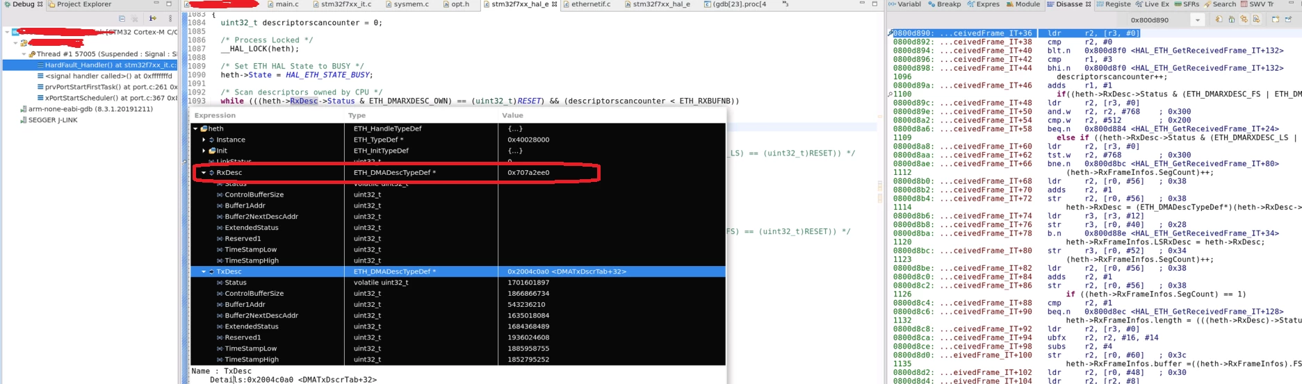

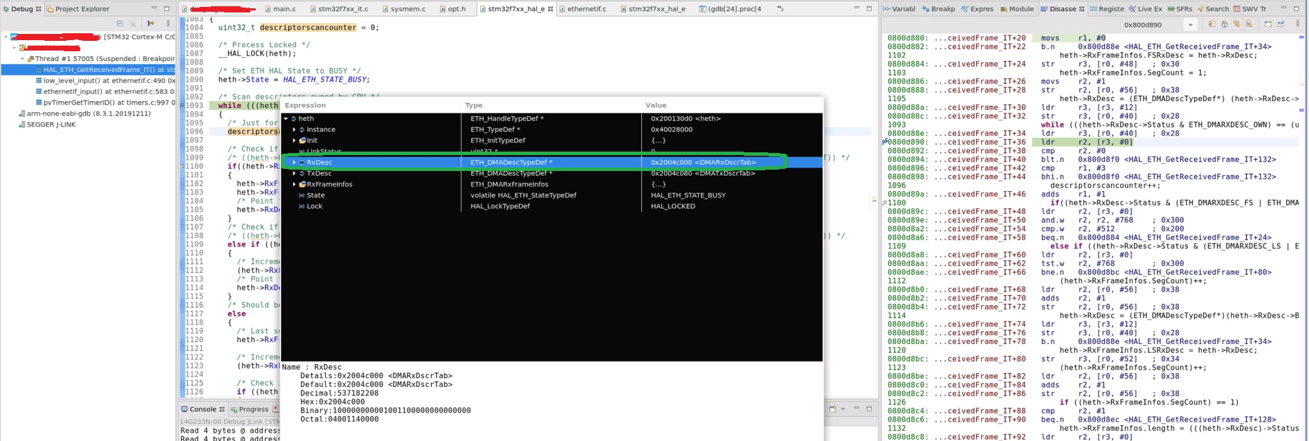

STM32F7 application based on freeRTOS and lwIP crashes due to PRECISERR
I have developed an application based on lwIP and freeRTOS for STM32F746NGH6. The code was generated using STM32CubeMX, freeRTOS version 10.2.1, CMSIS-RTOS version 2.00 and Cube FW F7 V1.16.1.
The application runs a webserver and receives data from a client at the rate X Bytes/min.
The program crashes after around 60 hours. To quickly test this, I reduced the data
reception rate at X Bytes/4sec. The program crashed after around 10 minutes. The analysis
using fault analyzer of STM32CubeIDE showed that the cause of the crash is precise data bus access error (PRECISERR).
The cause of error seems to be the function HAL_ETH_GetReceivedFrame_IT. Please see the
attached snapshots (good case and bad case). According to me, at the time of crash, the address of RXDesc ist invalid which is causing the PRECISERR. Normally the address of RXDesc is 0x2004C000 but I do not understand how this is getting corrupted.
Most likely an out of bounds write somewhere in the program.
If it's repeatable, set up a hardware watchpoint for RXDesc and you can see exactly when/where it gets changed.

Thanks for the hint. I set a watchpoint and I could see that DMA descriptor pointer are corrupted in HAL_ETH_GetReceivedFrame_IT function while returning (at return HAL_OK).

Now I get IMPRECISE error. Fault analyzer PC is pointing to memcpy instruction and link register to the instruction from low_level_output function. Here the excerpt from the function.
   /* Copy the remaining bytes */
     memcpy( (uint8_t*)((uint8_t*)buffer + bufferoffset), (uint8_t*)((uint8_t*)q->payload + payloadoffset), byteslefttocopy );
     bufferoffset = bufferoffset + byteslefttocopy;
     framelength = framelength + byteslefttocopy;
I am using configUSE_NEWLIB_REENTRANT=1 option in freeRTOS. I don't know why it crashes at memcpy function.
