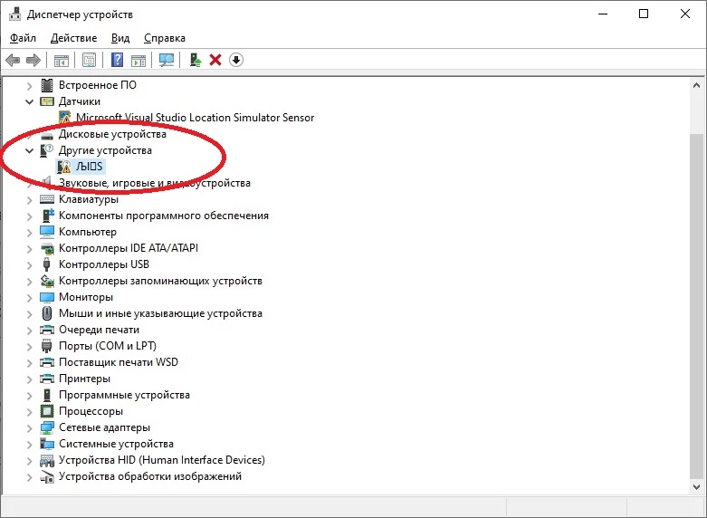

Problem:
Usb not working properly.
Solution:
FunctionUSB_WritePMA, not working properly when project compiled using -O3 optimization option. Let's look at the file stm32l4xx_ll_usb.c. Pls. look at the function

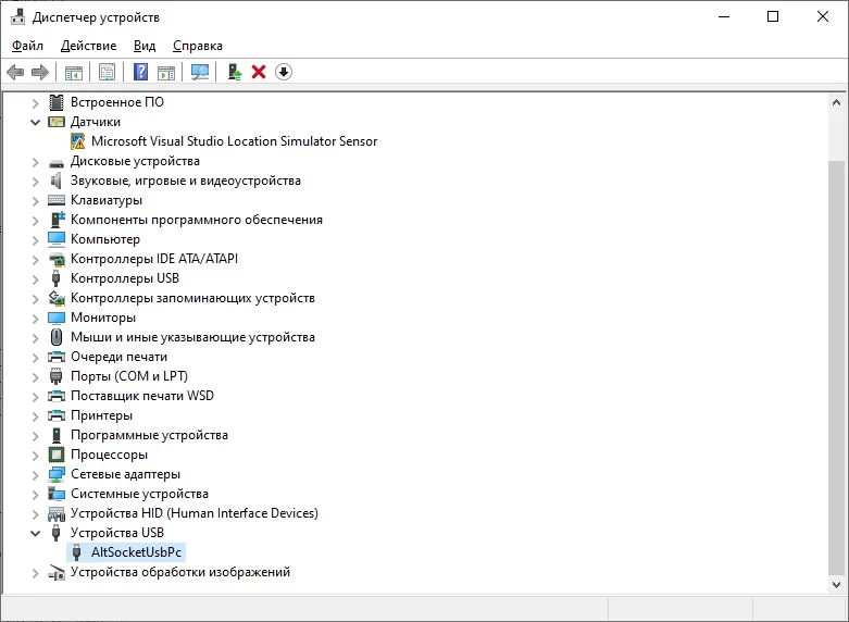

volatile uint16_t *pdwVal;
After fix:
