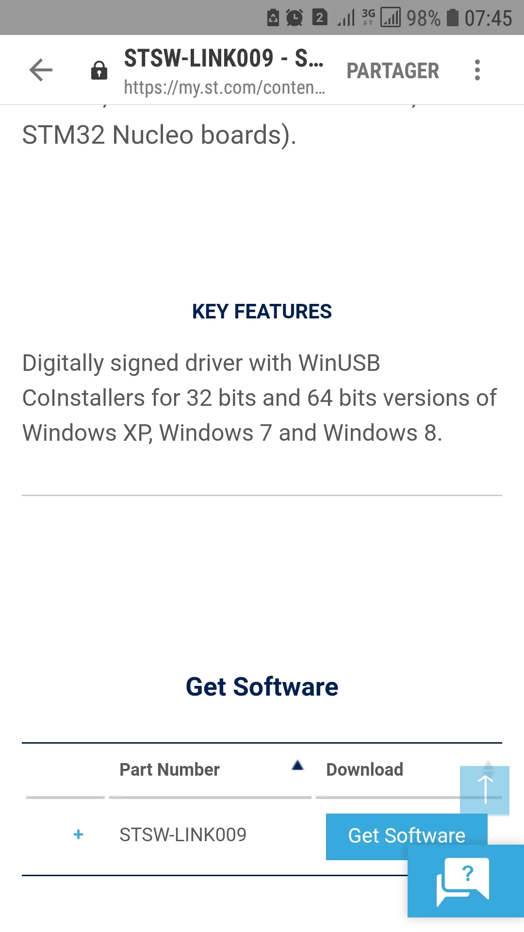

Hi all,
I want to handle STM32F407 Disco via VCP. In the first case, i tried to configure UART but when i connect my USB TTL converter to my PC: it informs me that VCP error ''This device cannot start(code 10)''.
I thought that the probem is related to my USB converter
Then i tried to configure CDC USB:
USB_OTG_FS on mode Device only
activate USB_Device middelware in CDC mode
check the CubeMX file attached for more details
but the problem still exist!===> VCP error ''This device cannot start(code 10)''.
and here is the define in "usbd_desc.c" file
#define USBD_VID   1155
#define USBD_LANGID_STRING   1033
#define USBD_MANUFACTURER_STRING   "STMicroelectronics"
#define USBD_PID_FS   22336
#define USBD_PRODUCT_STRING_FS   "STM32 Virtual ComPort"
#define USBD_SERIALNUMBER_STRING_FS   "00000000001A"
#define USBD_CONFIGURATION_STRING_FS   "CDC Config"
#define USBD_INTERFACE_STRING_FS   "CDC Interface"
=====> Please how can i handle to fix this issue! if there is a wrong value generated by CubeMX! or a change that should i do in my environement (PID, VID....)
this is a real problem for me that block my project0
Please any solution or workaround for this
many thanks

thanks for your response .. but i dont think that it will fix it .. this driver is already installed in my pc but it didnt resolve VCP error code 10 in windows 10.
