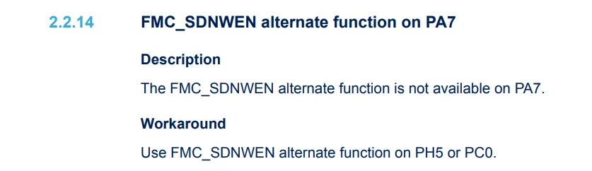

Shubha_99Best answer
May 8, 2026 10:03 AM UTC
Issue resolved.
After reviewing the STM32F469 errata sheet, it was identified that PA7 does not support the FMC_SDNWEN alternate function. However, during code generation, PA7 was configured for FMC_SDNWEN, which was misleading.
After reconfiguring FMC_SDNWEN to a valid pin as mentioned in the errata sheet, the SDRAM started working correctly.
Attached the errata reference image for clarity.

Shubha_99AuthorBest answer
Issue resolved.
Could you please share your ioc file on which PA7 is enabled for FMC_SDNWEN by CubeMx by default?
Shubha_99Author
May 8, 2026 10:34 AM UTC
I am currently unable to share the .ioc file, but the issue can be reproduced with the following steps:
  1. Create a new project for STM32F469ZIT6.
  2. Enable SYS and RCC.
  3. Enable LTDC.
  4. Enable I2C1.
  5. Enable FMC.
After enabling FMC, PA7 gets assigned for FMC_SDNWE.
Thank you for the support.
