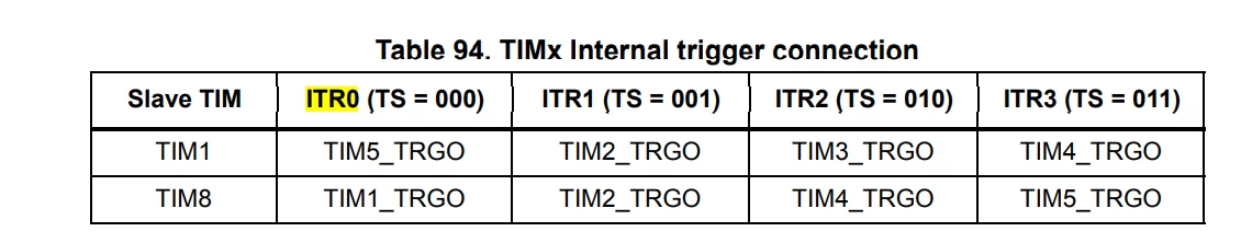

 I know TIM2_TRGO should get in ITR1 of TIM1 according to this chart.

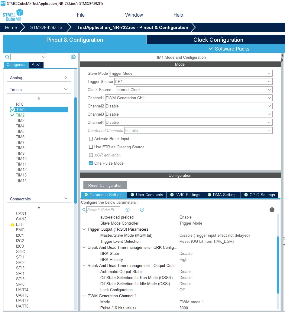

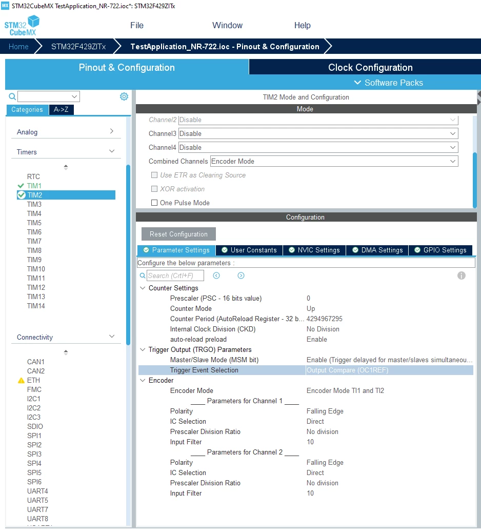

0693W00000Kb1XoQAJ.pnghere is my setup on CubeMX;

> I would like the Trigger Event of TIM2 to be generated when the Encoder count reach a specific position.
You would need to set an Output Compare on one of the remaining channels (i.e. CH3 or CH4 - say you've chosen CH3), set the required value into TIM2_CCR3, set TIM2_CCMR2.CC3S to Output Compare and TIM2_CCMR2.OC3M to one of the PWM modes (exactly as if you'd set up a PWM, except you don't need to actually assign a pin in GPIO), and set TIM2_CR2.MMS to 0b110 -  OC3REF signal is used as trigger output.
That last item is probably done by
> sMasterConfig.MasterOutputTrigger = TIM_TRGO_OC3REF;
but I don't use Cube.
Note, that depending on the chosen PWM mode, slave would be triggered only upon upcounting or only upon downcounting.
DPatr.2
DPatr.2Author
March 1, 2022
So Channel 3 Output Compare No Output would be the internal line on which the trigger signal from TIM2 to TIM1 when TIM2_CNT reaches TIM2_CCR3 value, if I understand correctly ?
