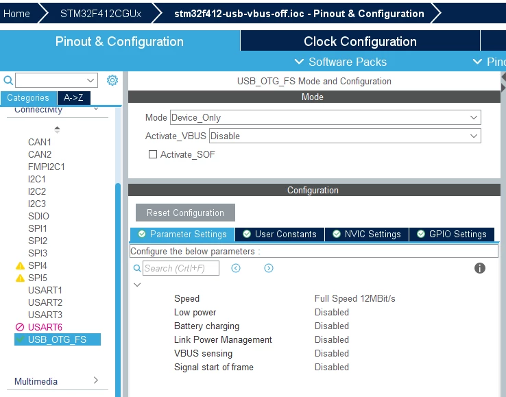

I am using CubeMX v6.1.1 with CubeF4 v1.25.2 to generate code for STM32F412CGUx with STM32CubeIDE.
The app generates usbd_conf.c with following function included:
 * @brief Handle USB VBUS detection upon external interrupt
 * @param GPIO_Pin
 * @retval None
void HAL_GPIO_EXTI_Callback(uint16_t GPIO_Pin)
 if (GPIO_Pin == GPIO_PIN_9)
 HAL_PCDEx_BCD_VBUSDetect(&hpcd_USB_OTG_FS);
This causes linkage errors when there is a user-implemented EXTI Callback.
The issue happens regardless of VBUS Sensing setting in CubeMX - even when it is off, the callback still gets generated (not saying it should be generated that way when VBUS Sensing is on, because it is messing up the use of callback by user).
This was reproducible with STM32F412RE but NOT with STM32F446RE or STM32F411CEUx
Please see generated files attached.

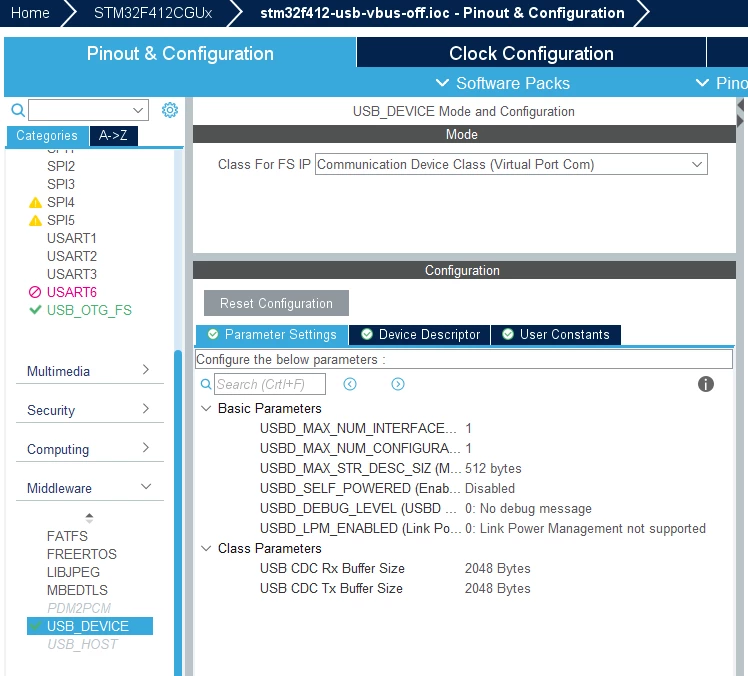

USB Peripheral and Middleware settings used:
1 reply

Hello @fronders​ ,
Thanks for your feedback and for raising this issue, you're right HAL_GPIO_EXTI_Callback() is generated in the usbd_conf.c file regardless of VBUS Sensing setting in CubeMX.
This problem was already reported to our development team to be fixed as soon as possible. I'll surely keep you posted with updates.
Sorry for any inconvenience that this may cause.
Thanks a lot for you contribution.
