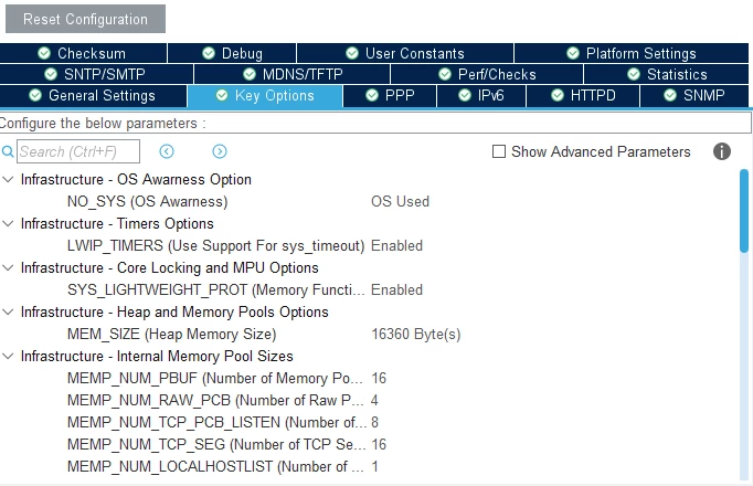

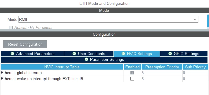

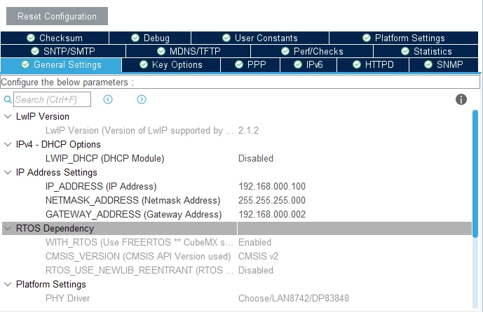

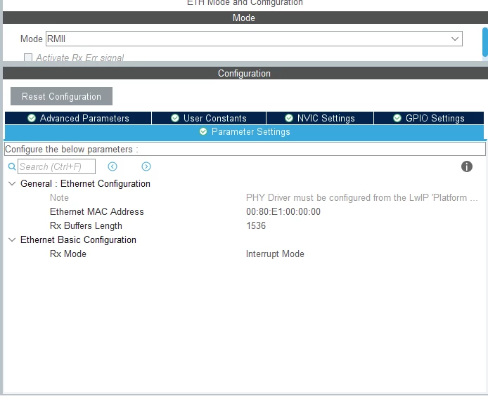

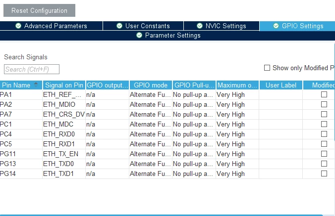

hello every one,
I have one STM32F407ZTE board with DP83848 as PHY.
I want to use STM32cubeMX as initialization code generator.
STM32F4 version is 1.27.1. I try with and without RTOS v2, but I can get ping.

0693W00000QO7mTQAT.png0693W00000QO7miQAD.png0693W00000QO7mnQAD.png0693W00000QO7n2QAD.png0693W00000QO7nCQAT.png0693W00000QO7n7QAD.png

Try to switch to MII mode (Since it's the default mode and maybe there's a HW rework to make to activate the RMII mode) and ensure that the default task stack size is sufficient (larger than 1024). Normally it should work.

This solves the problem, it is necessary. (default task stack size is sufficient (larger than 1024).)
