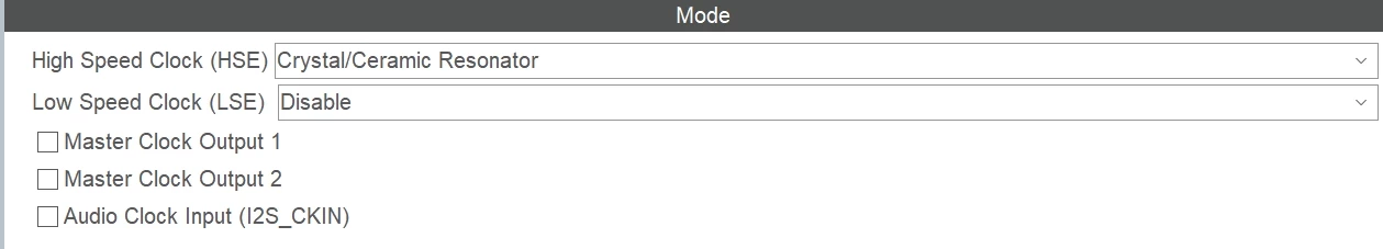

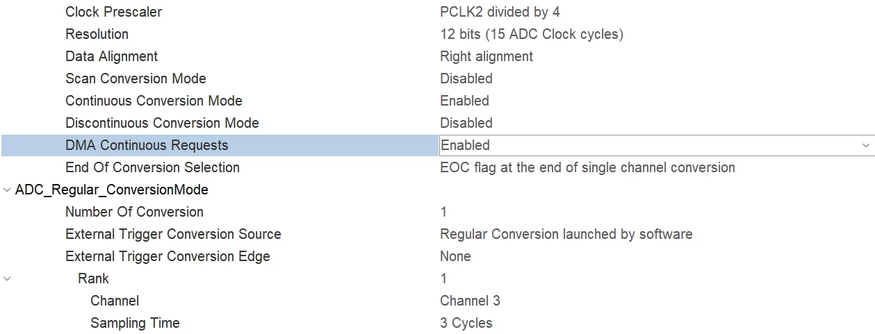

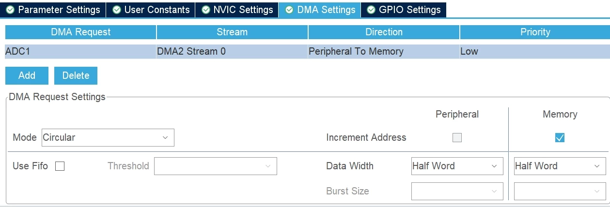

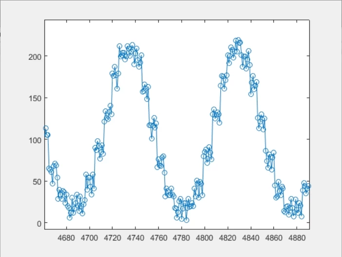

Stm32f407ve ADC+DMA used 1KHz sin is not read evenly when reading the reason
  • February 17, 2021
  • 1593 views
Stm32f407ve used ADC+DMA used 1KHz sin is not read evenly when reading the reason
0693W000008GNiKQAW.jpgExternal 8MHz crystal and UART asynchronous use
0693W000008GNlxQAG.jpg0693W000008GNlJQAW.jpg0693W000008GNl4QAG.jpg0693W000008GNkzQAG.jpg

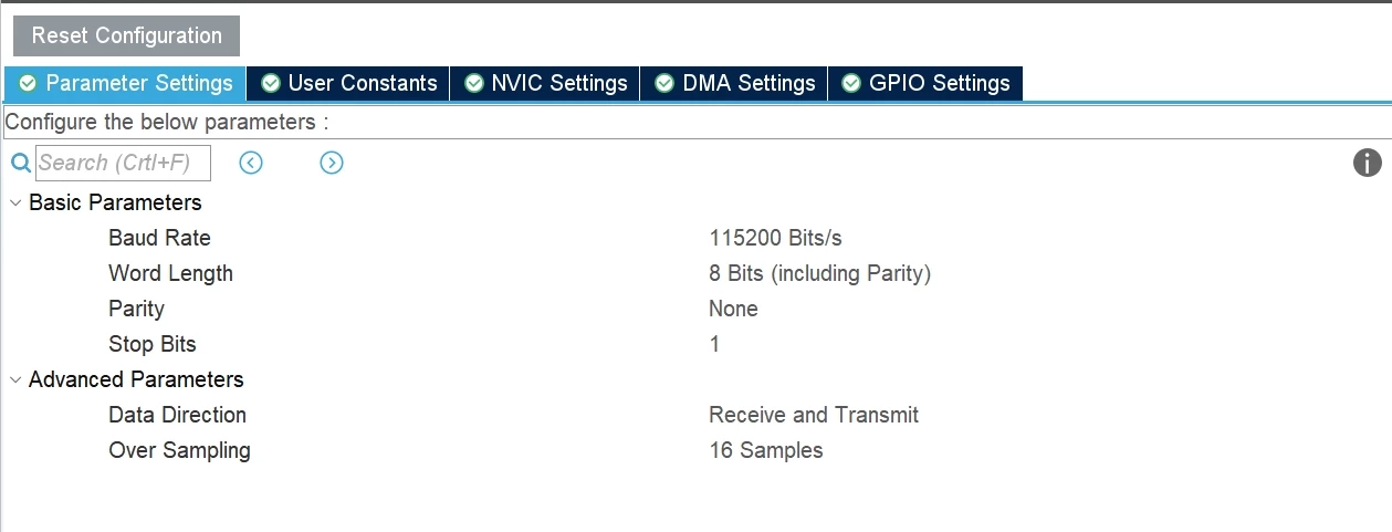

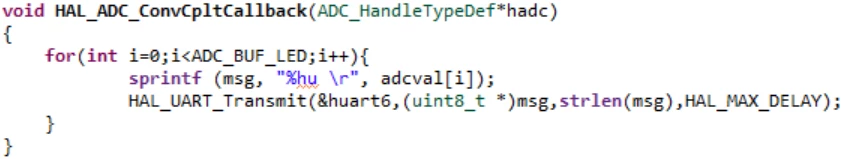

You don't look to be pacing with a TIM, assume that you are saturating the USART.​
Jkong.1
Jkong.1Author
February 18, 2021
I did not use the TIM. How to fix if USART is saturated? The code using USART was uploaded as a photo attachment.
