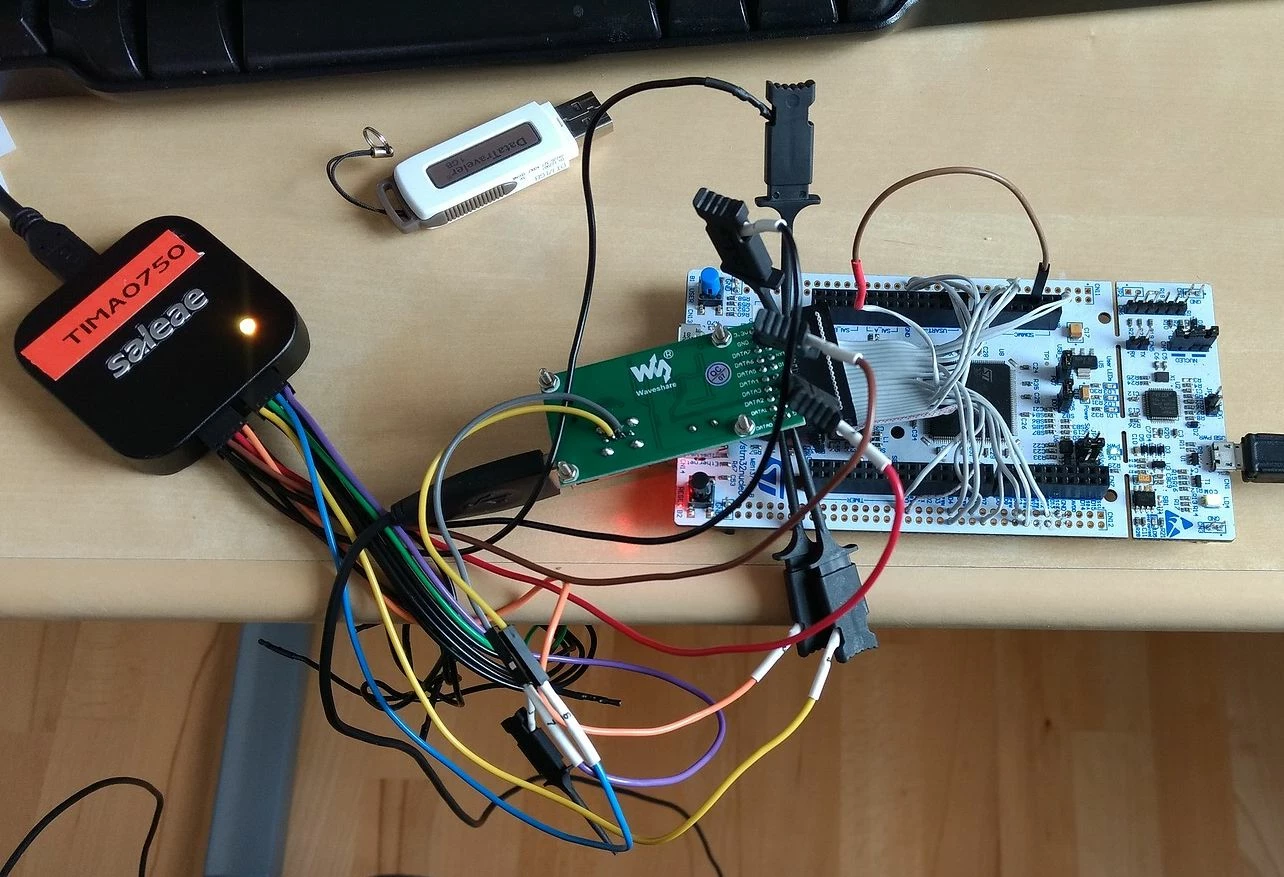

i try to implement an USB3300 ULPI PHY on STM32F429ZI Nucleo which an attached "daugtherboard", a WavesShare USB3300 USB HS Board, populated with an SMSC USB3300.
I want connect an USB stick to write down some data in High Speed mode. I am using the STM32F429 ZI USB HS ULPI interface.

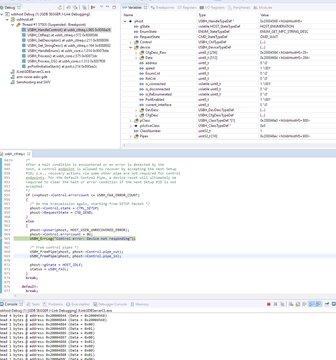

Here is a screenshot of a breakpoint including caller stack and variable view

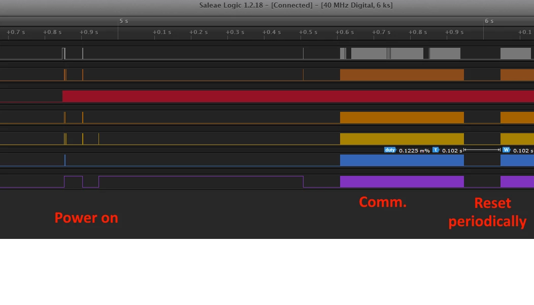

I tried to use an eight channel logics analyzer (Saleae Logics) which is way too slow to handle the 60 Mhz Clock output or the 2.0 data lines (480 Mhz).
But I see signals and the reset behaviour

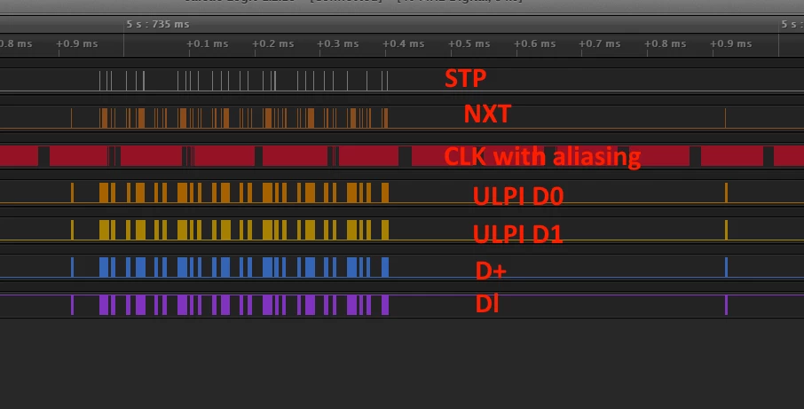

A closer look into the communication with the signal names.
It shows maybe the communication of the vendor and devide ID.

I would be surprised if those 60MHz signals you can't capture with your LA would work properly over a bird's best of flying leads. Even if you'd use a proper return/ground for each signal - which I doubt you do.
