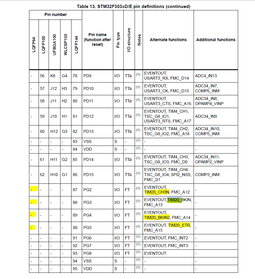

Hi, I am looking forward using the TIM20 timer as per datasheet says on a STM32F303RE (nucleo-eval board) but the STM32CubeIDE only show timer up to number 17.
Is this a bug?
TIM20 is well suited for all 303xD/E that have at least 100 pins ( so not 303R--). So, in the datasheet you must be able to find that TIM20 is not there on the 64 pins.

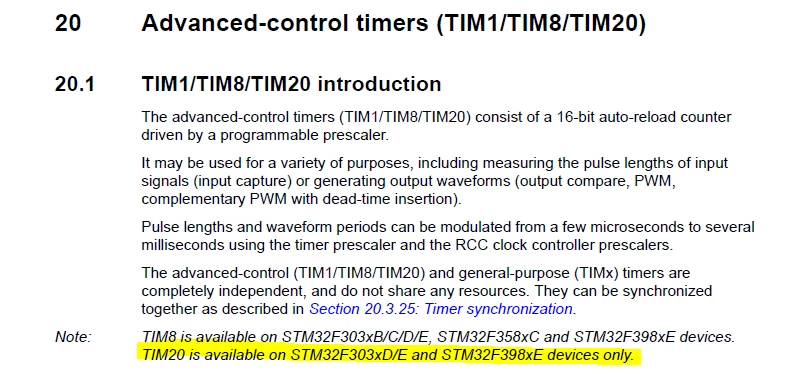

Hi @CGAIR​
TIM20 is available on STM32F303xD/E and STM32f398xE devices only.

Not the OP, but the mentioned STM32F303RE is a STM32F303xD/E

waclawek.jan
May 15, 2019 12:27 PM UTC
I guess, TIM20 is still there, it's just that it has no pins brought out.
