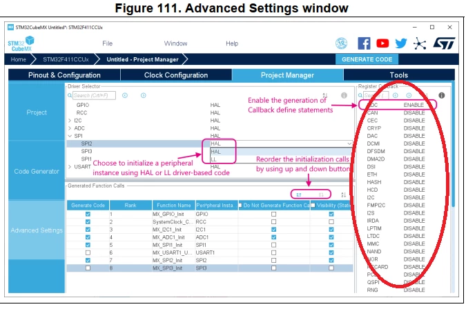

STM32F2xx "USE_HAL_xx_REGISTER_CALLBACKS": where to set them in CubeIDE?
I use CUBEIDE 1.3.0 with MCU Package STM32F2 V1.9.0 for Nucleo F207.
This package generates a file "stm32f2xx_hal_config.h". In this file, all "USE_HAL_***_REGISTER_CALLBACK" defines are set / not set.
What is the proper way to enable these defines? I don't find a switch within the CubeIDE environment. These defines are not in a Begin_user / End-User section. If I enable one, it got overwritten by next time code-generation.
Other CPU types like STM32L4 MCU Packages don't generate these defines, I normally set these as global define with the compiler preprocessor settings.
With F2xx MCU Package, this does not help. The compiler complains about "redefinition" of these defines.

jnewcomb
jnewcombBest answer
Jan 28, 2021 10:17 AM UTC
Now supported in CubeMX. From the help PDF:

jnewcomb
jnewcombBest answer
