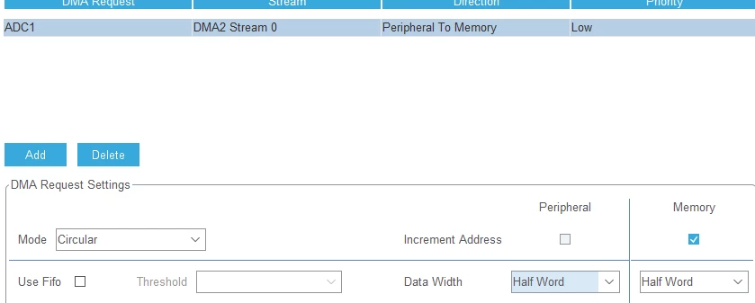

Hola, i have been succesfully using DMA+ADC in stm32f072/f103/f105.
ADC in Scan+Continuous mode. (15 channels enabled)
But now im trying to use stm32f207 (NUCLEO-f207zg) , the DMA works one time(first channel) and dies.
DMA interrupt IRQ is only triggered 2 times (mid transfer and transfer completed of the first adc channel)
What am i missing , what is different in stm32f207?

  • inside void HAL_ADC_MspInit(ADC_HandleTypeDef* hadc)
/* ADC1 DMA Init */
 /* ADC1 Init */
 hdma_adc1.Instance = DMA2_Stream0;
 hdma_adc1.Init.Channel = DMA_CHANNEL_0;
 hdma_adc1.Init.Direction = DMA_PERIPH_TO_MEMORY;
 hdma_adc1.Init.PeriphInc = DMA_PINC_DISABLE;
 hdma_adc1.Init.MemInc = DMA_MINC_ENABLE;
 hdma_adc1.Init.PeriphDataAlignment = DMA_PDATAALIGN_HALFWORD;
 hdma_adc1.Init.MemDataAlignment = DMA_MDATAALIGN_HALFWORD;
 hdma_adc1.Init.Mode = DMA_CIRCULAR;//<----------------------------------------------------:D
 hdma_adc1.Init.Priority = DMA_PRIORITY_LOW;
 hdma_adc1.Init.FIFOMode = DMA_FIFOMODE_DISABLE;
  • Inside HAL_DMA_Init
/* Write to DMA Stream CR register */
 hdma->Instance->CR = tmp;// <---- hdma->Instance->CR doesnt get tmp value for some reason, it remains 0
 I cannot change the value manually in the Debugger Expressions window.......
Something is preventing this memory to being written, something is preventing the init code to write the configurations in the DMA2 Stream0 registers.0693W00000GWRh5QAH.pngThat memory addr 0x40026410 happens to be where DMA2 Stream 0 peripheral is mapped, as expected in my cubeMX configuration.

Javier1
Javier1AuthorBest answer
Principal
November 4, 2021
As @Bruno_ST​ pointed out here all this buzz happened because cubeMx tries to config the DMA before its clock is enabled.
0693W00000GWS5bQAH.pngI just changed the order of how DMA and ADC are initialiced and it works now.
