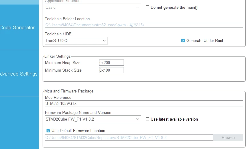

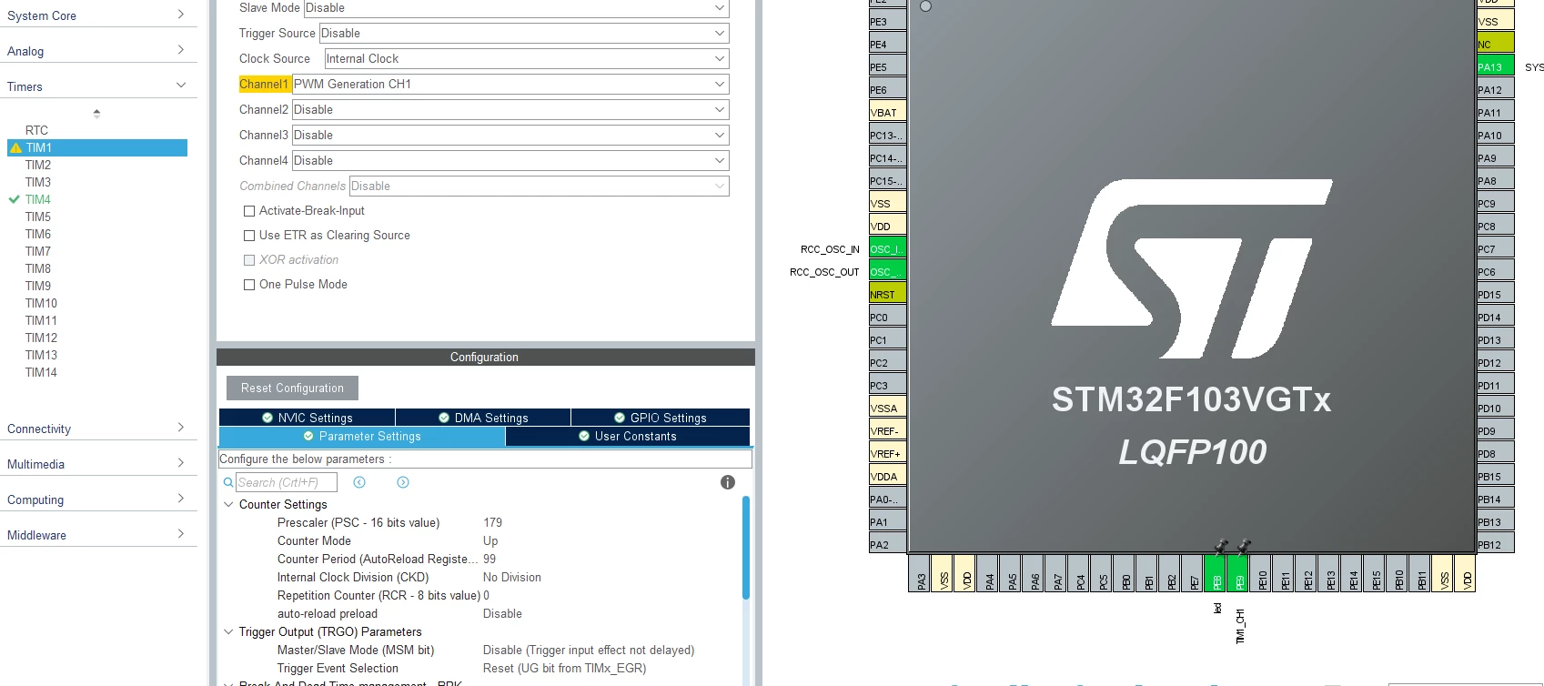

STM32F103VG Use Cubemx to generate TIM1 CH1 PWM output, and use firmware version stm32cube FW_ F1 v1.8.1 has normal PWM output. Use firmware version stm32cube FW_ F1 v1.8.1 ~ v1.8.4 cannot output PWM.

void user_pwm_setvalue(uint16_t value)
TIM_OC_InitTypeDef sConfigOC;
sConfigOC.OCMode = TIM_OCMODE_PWM1;
sConfigOC.Pulse = value;
sConfigOC.OCPolarity = TIM_OCPOLARITY_HIGH;
sConfigOC.OCFastMode = TIM_OCFAST_DISABLE;
HAL_TIM_PWM_ConfigChannel(&htim4, &sConfigOC, TIM_CHANNEL_1);
HAL_TIM_PWM_Start(&htim4, TIM_CHANNEL_1);
sConfigOC.Pulse = 95;
HAL_TIM_PWM_ConfigChannel(&htim1, &sConfigOC, TIM_CHANNEL_1);
HAL_TIM_PWM_Start(&htim1, TIM_CHANNEL_1);
int main(void)
/* USER CODE BEGIN 1 */
/* USER CODE END 1 */
HAL_Init();
/* USER CODE BEGIN Init */
/* USER CODE END Init */
SystemClock_Config();
/* USER CODE BEGIN SysInit */
/* USER CODE END SysInit */
MX_GPIO_Init();
MX_TIM4_Init();
MX_TIM1_Init();
/* USER CODE BEGIN 2 */
user_pwm_setvalue(80);
/* USER CODE END 2 */
/* Infinite loop */
/* USER CODE BEGIN WHILE */
while (1)
/* USER CODE END WHILE */
/* USER CODE BEGIN 3 */
/* USER CODE END 3 */
