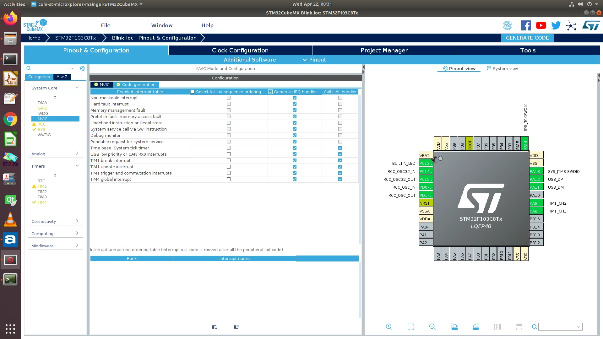

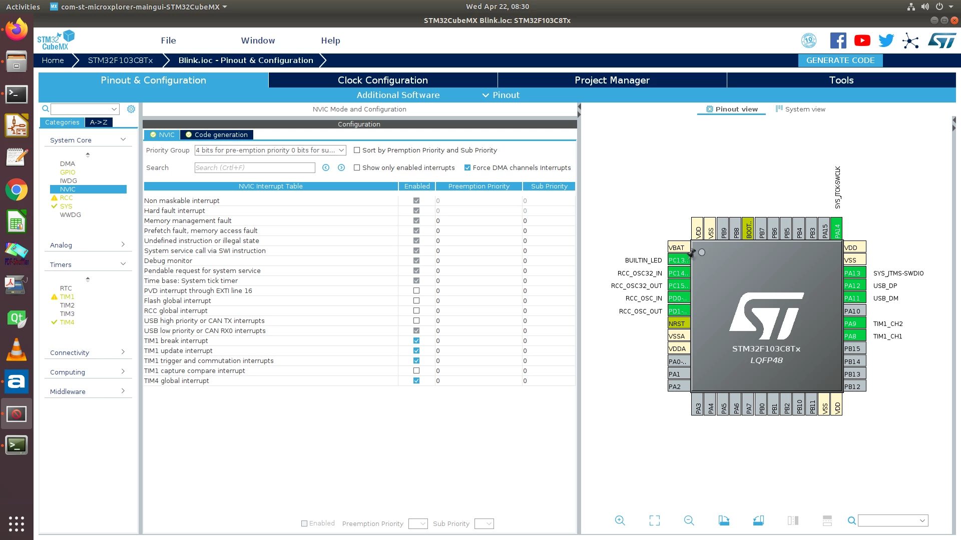

Apr 22, 2020 3:19 AM UTC
Added a GPIO toggle into TIM1_UP_IRQHandler() and it does not get called.... about the TIMx_DIER and diasm... i will need a little bit more time....
The interrupt is enabled in NVIC (CubeMX) and Call HAL handler is also enabled (attached screen shot)
I have also checked that is TIM1 is setup as Base Timer the update handler works
In the chained setup of update trigger from TIM1 to TIM4 and TIM4 global interrupts enabled, I am getting trigger so TIM4->CNT increases on over/Under flow of TIM1
So i thought i could get Periad Elapsed for TIM4, so TIM4 ARR was set to 0, to get TIM4 Update on each trigger....Surprisingly update does not trigger So I set TIM4 ARR to 1 and TIM4 update gets triggered... however in the handler the instance checking does not work i get only "P_E" in the output....

screen shots here... forgot to attach
