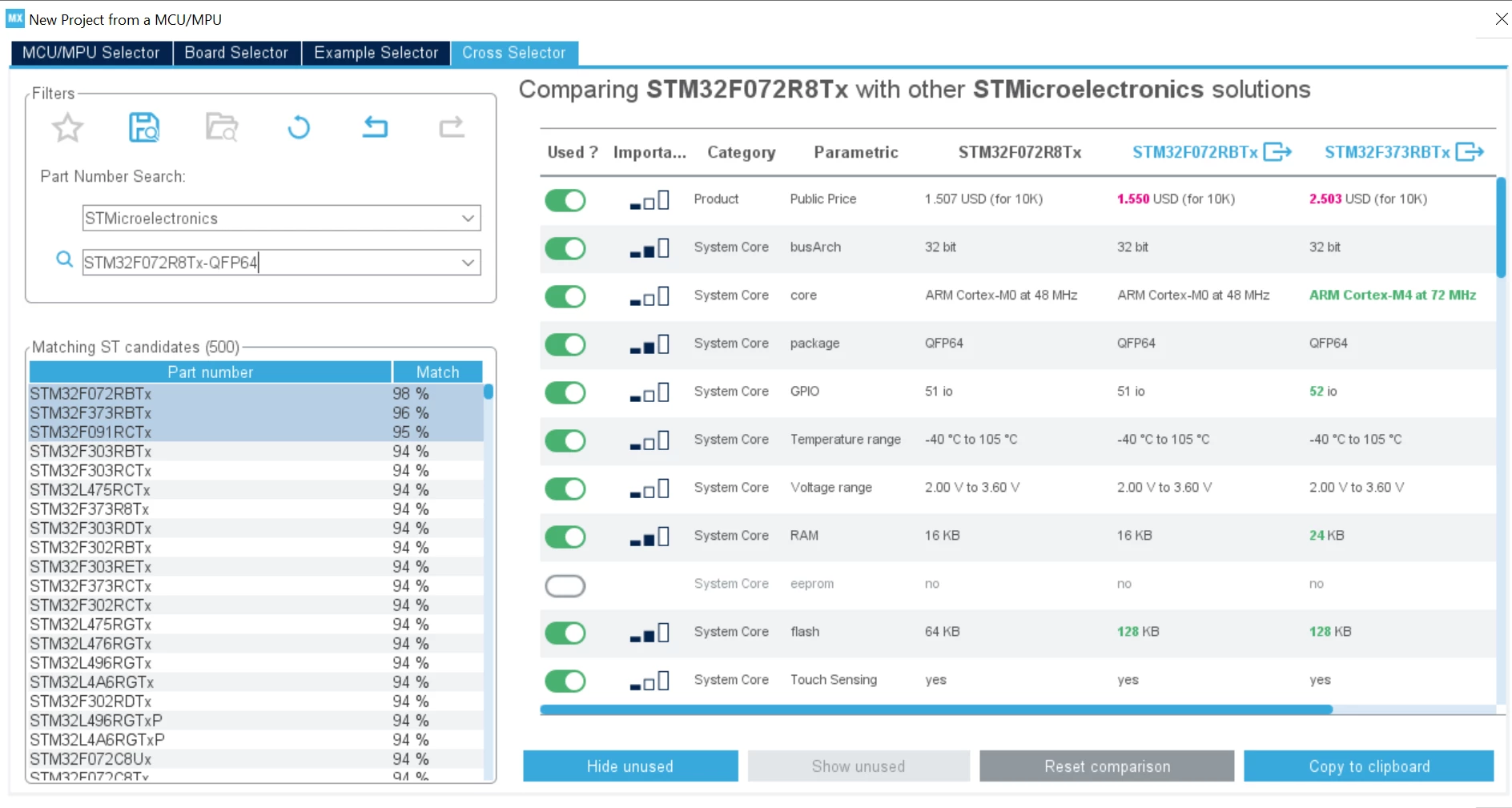

STM32F072RB compatible MCU's in ST
Is there any pin-to-pin compatible controller available with STM32F072RBTx MCU in ST. Compatible controllers can be with Higher FLASH & RAM size.

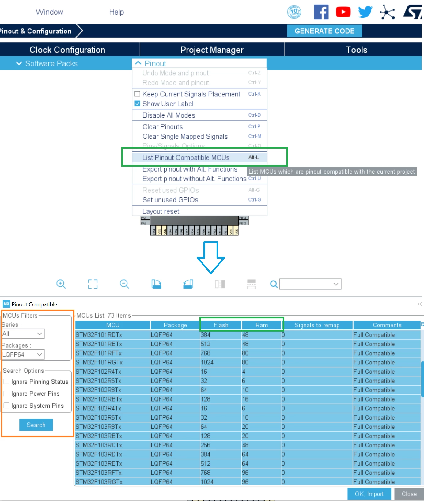

Hi @LRPS_92​
I recommend you to use the list of pinout compatible MCUs via CubeMX, you need to start by creating a new project using your MCU part number, press ALT+L to get the list of all compatible MCUs:
0693W000006HGj0QAG.pngI take this opportunity to present you another way to compare one or more MCUs and it is through the Cross Selector also in CubeMX:
Hope that I helped you, when your question is answered, please close this topic by choosing Select as Best. This will help other users find that answer faster.
Thanks, Khouloud

There's a great deal of compatibility across the whole 'F0 subfamily. If you are willing to migrate to a different family, check 'L0 and 'F3.
