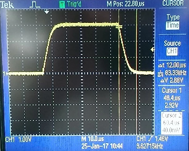

Hi everyone, I try to generate PWM signal usingSTM32F072B. I set the PA0 as TIM2 and set channel 1 to PWM Generation and set the GPIO maximum output speed to high. The other configurations aredefault. In the main function, I add theHAL_TIM_PWM_Start(&htim2, TIM_CHANNEL_1); before the while loop and change the number of thehtim2.Init.Prescaler,htim2.Init.Period andsConfigOC.Pulse.The PWM signal is generated but ithas 12us rise/fall time, the attachment the snapshot of the signal. The code below is generated by using CubeMx ver4. Anything I missed out?

I found that this problem does not occur when using PA5 instead of PA0. But why? Because PA0 is connected to User button?
