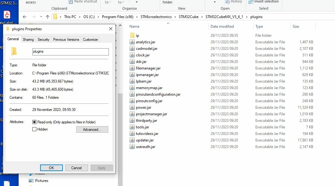

Hello @patm
Could you share the content of the STM32CubeMX\plugins\ folder and the access right given to this folder.
According to the log file some plugins (projectManager, filemanager, pinoutconfig) seems to be missing.
patmAuthor
Dec 20, 2023 11:47 AM UTC
Please find attached.
