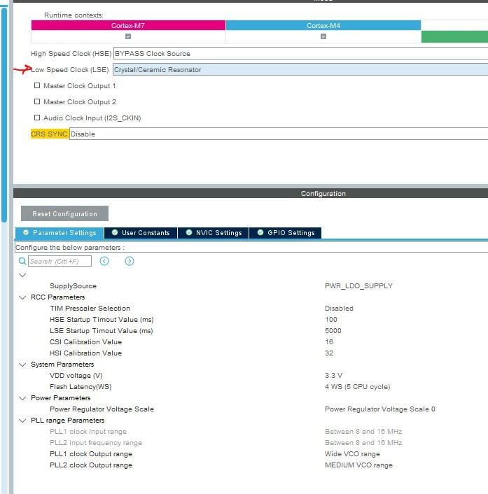

Hello, i have found some bugs
I can't select the external 32 khz osc .

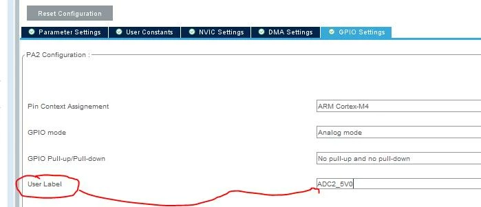

the input field of the User Label have some problems
edit this fields don't work properly
CTRL + c/v don’t work

So to conclude, for the first problem related to LSE activation : you need to Enable RTC if you want to change RTC Clock Mux.
For the seconde one which is a problem with User Label, thanks for sharing your ioc file to reproduce the issue, you're right and it will be fixed.

For the LSE Problem : you need to Enable RTC in you want to change RTC Clock Mux.
For the User Label and fields Problem : Can you please explain more what's exactly the issue, seems Ok.

->For the LSE Problem : you need to Enable RTC
yes, it works thanks

Enter User label in the Pinout view works good
only the UserLabel in the Configuration field is an problem

@Hans T​ ,
Please share your ioc file to check the problem, and can you specify where exactly the Problem ? ( Under which IP ? Pin name ? )
Your feedback on copy and paste will be important for me to help you solve this issue.
