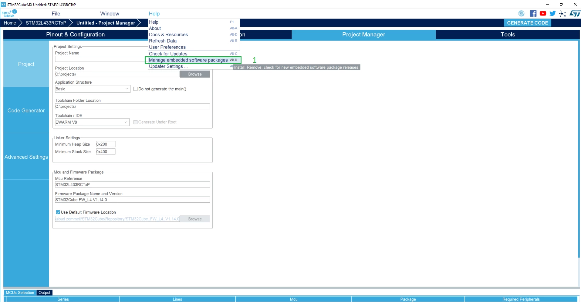

1- Select "Manage Embedded Software Packages" under Help0690X000008wQbyQAE.png

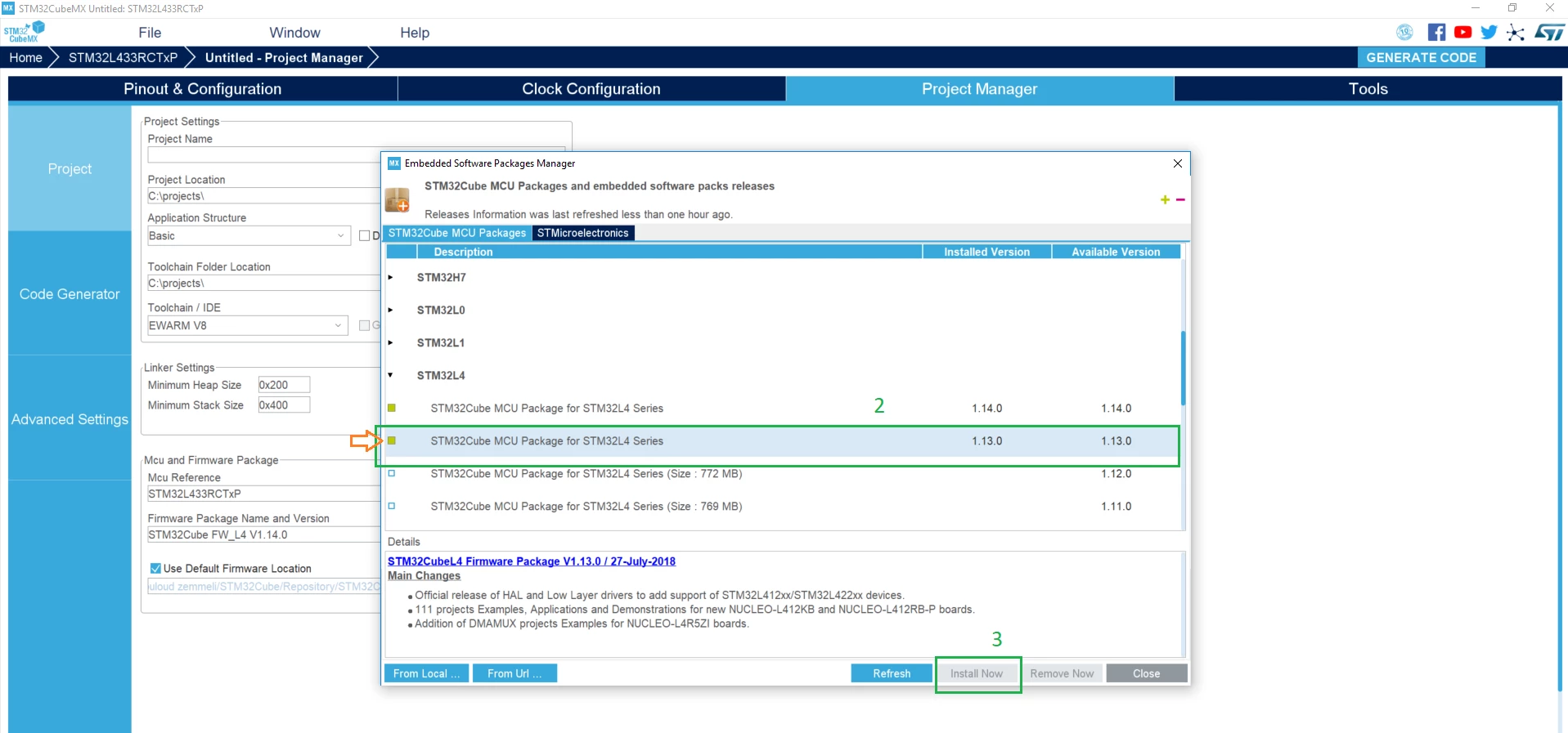

2- check the small box
Khouloud ZEMMELI

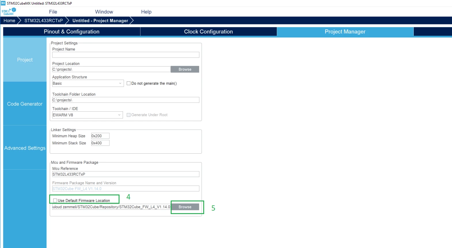

Wait until the install finish then :
4- Uncheck the small box beside Use Default Firmware Location
5- Select "Browse"

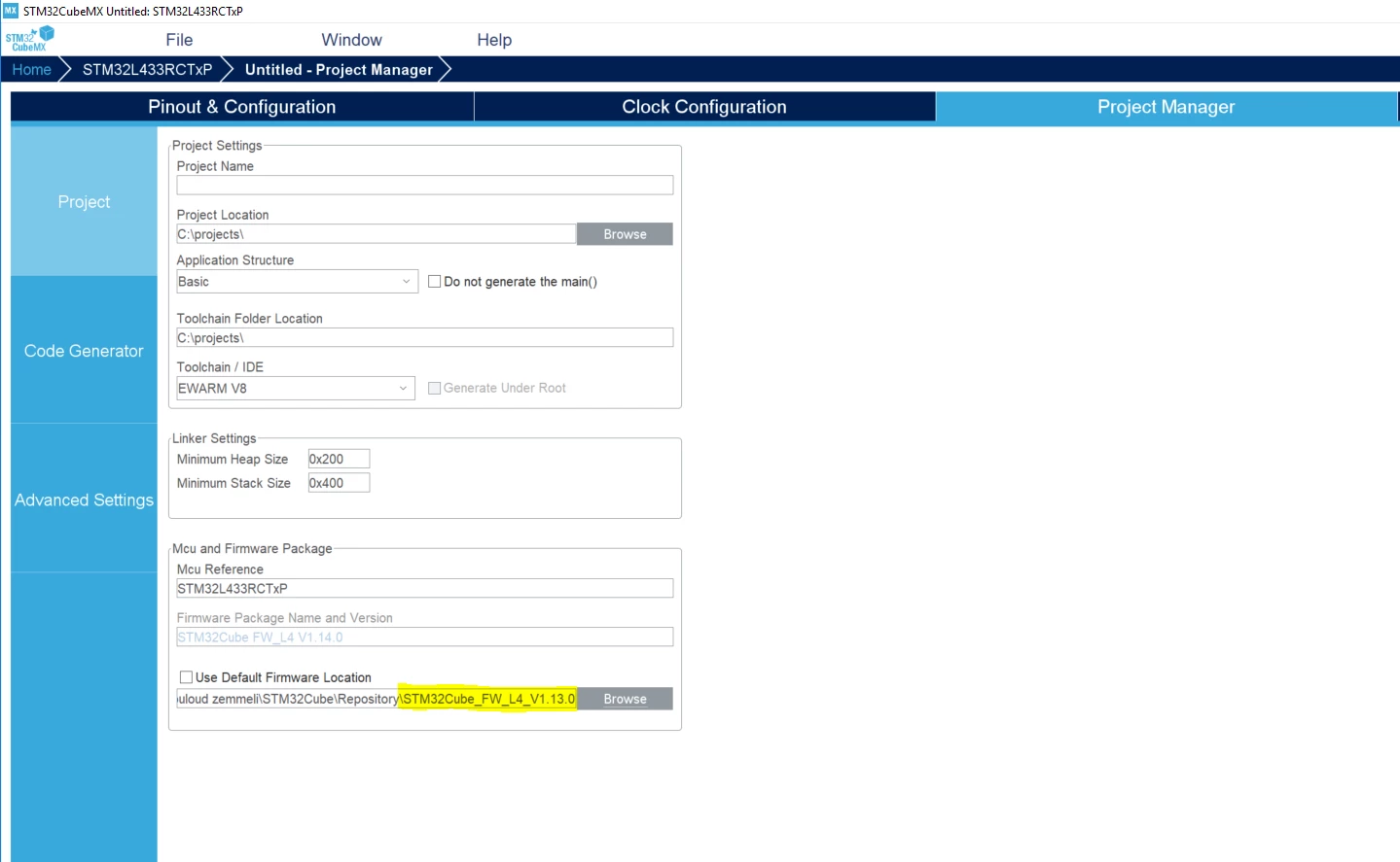

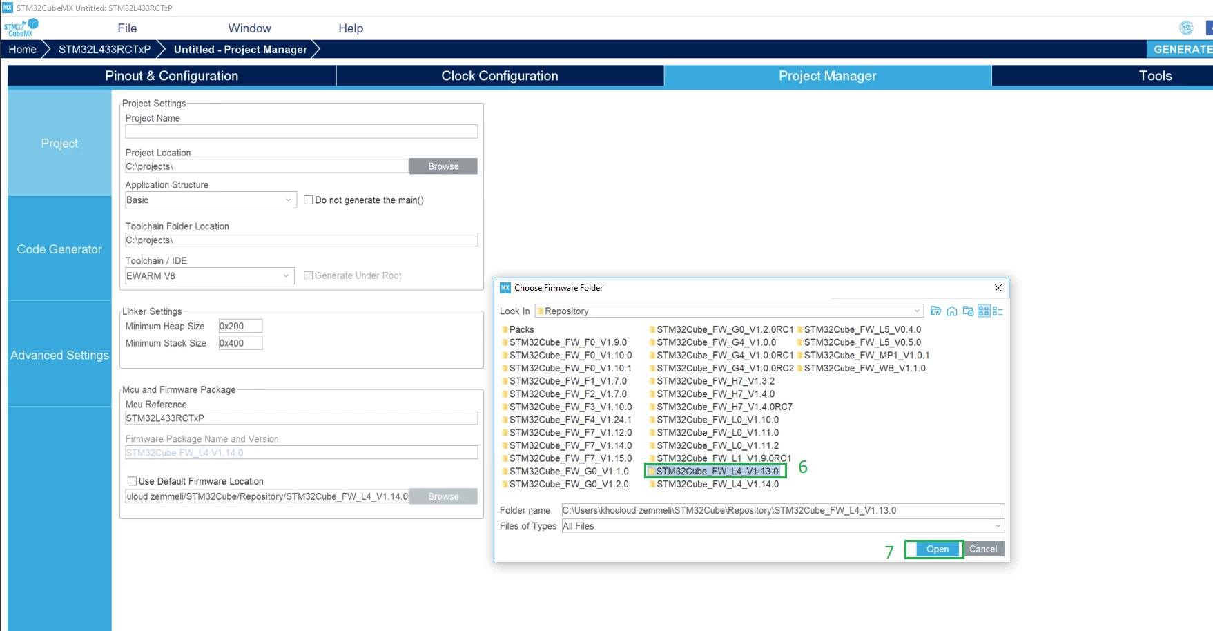

6- Select STM32Cube_FW_L4_V1.13.0
7- Select Open
Khouloud ZEMMELI
May 27, 2019 8:24 AM UTC
that's all.
