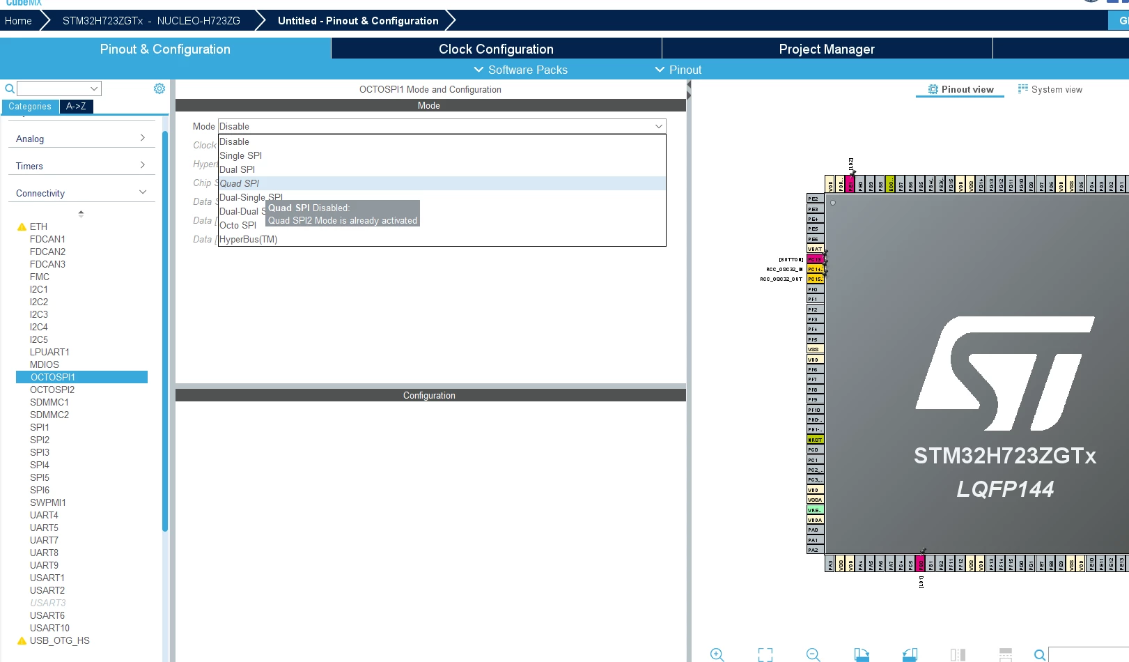

stm32cubemx V6.15 unable to enbale OSPI as QSPI mode
Hi
When I use stm32cubemx V6.15, I find that enbale OSPI as QSPI mode is not feasible.
It say another Quad spi is activated, but actully not.
When downgrade to V6.14, I can enable Quad spi.
Can you help confirm this issue?

Hello @Zhou JianQiang
Thank you for bringing this issue to our attention.
We are aware of the problem and have already reported it to our development team under ticket number 213718.
Our team is actively working on a resolution, and we will ensure it is fixed as soon as possible.
