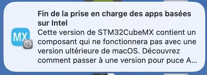

STM32CubeMX v6.0.7 on MAC (ARM): warning message
When I launch STM32CubeMX (version 6.0.7), a message appears (see the attached file)
Is there a plan to release an update that will allow this program to run without Rosetta?

Hello  @Andrei Chichak
Actually, this is a known issue, already reported to the CubeMX team under internal ticket ID #0061381, as discussed in this post
A fix is planned in the upcoming releases of CubeMX.

Hello  @FRAUBRY
Starting with CubeMX version 6.16.0, a new installer has been introduced with native support for Apple Silicon.
Two installer options are available:
- an ARM64 installer for Apple Silicon-based Mac computers
- an Intel installer for Intel-based Mac computers
We are currently aware of this limitation with Intel installer and of the removal of Rosetta support in future versions of macOS. An update is planned to address this issue in an upcoming version of CubeMX.

Thank you for your reply.
I downloaded the file SetupSTM32CubeMX-6.17.0-Mac-ARM.app.tar.gz and extracted it to get the installer SetupSTM32CubeMX-6.17.0.app
After launching this file, I successfully obtained the STM32CubeMX.app program.
It no longer generates the Warning!
Good!
But when I check the file information, it still shows Type: Application (Intel) instead of Type: Application (Puce Apple)" !!!
