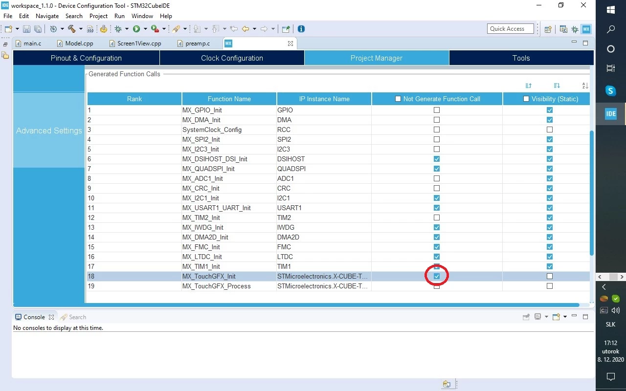

I write this as bugreport for IDE.
In my project i need start TochGFXINIT on other place as MX generated code do.
Then in STM32CubeMX v5.6 i use comment out it after every generate code.
Im happy with STM32CubeMX v6.0 i use checkbox in MX and call to function isnt generated URAA, but
next update STM32CubeMX v6.1 i 1.5.0 IDE and now checkbox again not working and call is generated allways

Hello @MM..1​
Can you please explain more your problem ?
Which check-box are you talking about ?
Khouloud
MM..1
MM..1Author
December 8, 2020
Marked checkbox dont work and is cleaned on save on 5.6 and 6.1, but work in 6.0
Khouloud ZEMMELI
December 10, 2020
If I understood you correctly, when you check the checkbox mentioned in the attached screenshot, save the project then re-open it, you find it unchecked, right?
Please share your ioc file, Khouloud
