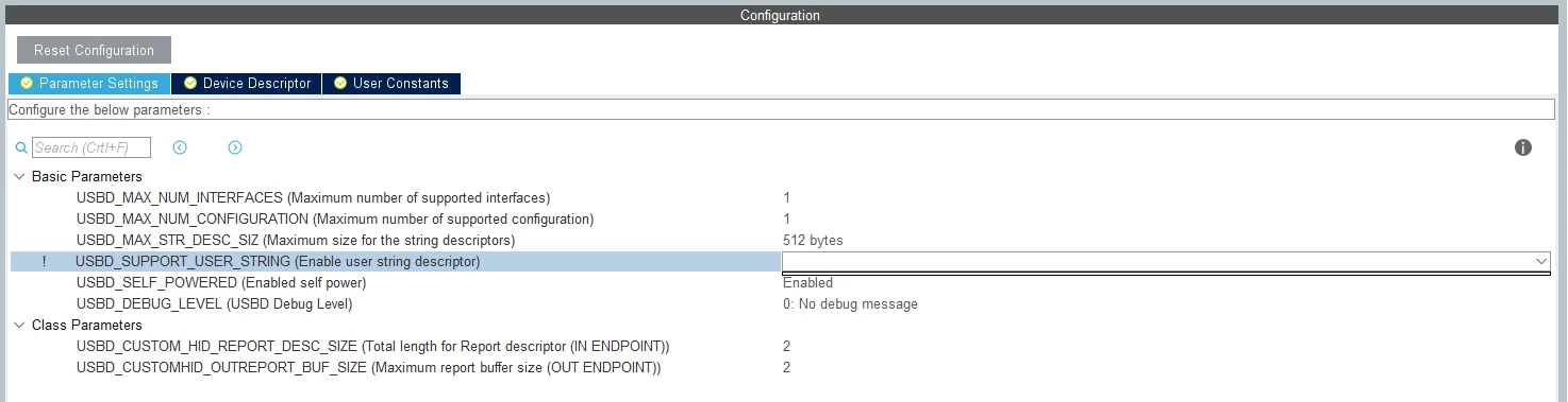

STM32CubeMx v5.1.0 USBD_SUPPORT_USER_STRING parameter can't have value edited
I am aware I am using a slight outdated version and so apologise if this fix has already been implemented.

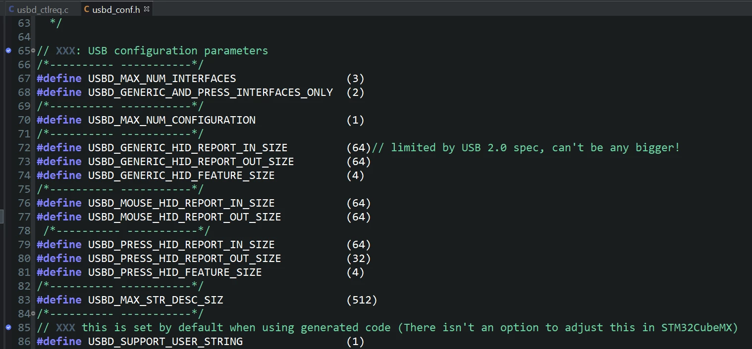

When selecting a Custom HID Class under the middleware tab there is no option to enable or disable the USBD_SUPPORT_USER_STRING parameter, and is then set to 1 by default after generating code. This resulted in a 2 day headache trying to debug why my device was hard faulting!
  • During enumeration if this parameter is set to 1 Windows will ask for a special descriptor, if this descriptor has not been coded/provided then the device will throw a hard fault.

Hi @Community member​
Using the latest CubeMX version (6.1.0) the USBD_SUPPORT_USER_STRING is no more available in Parameter Settings because is still not supported.
The USBD_SUPPORT_USER_STRING will be available (enable/disable) only when DFU is selected.
Thanks for your feedback, Khouloud
