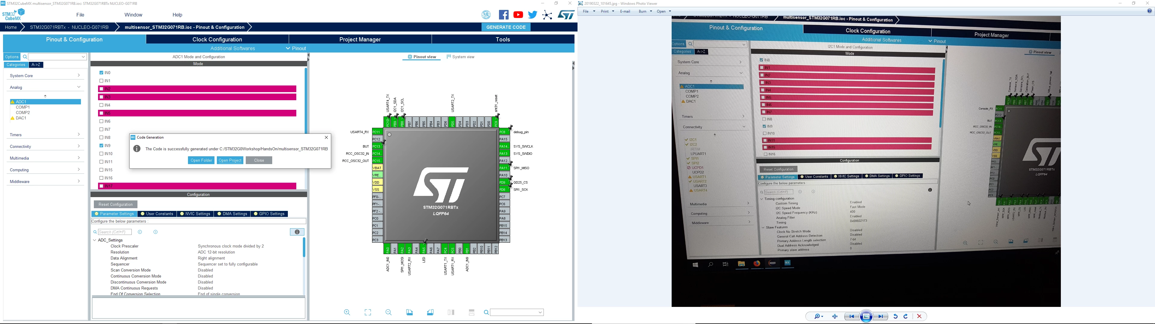

During the ADC configuration for STM32G071RB in CubeMX, the program hangs. This is only for ADC. I checked it on two computers.

Dvorak.Peter Can you check this file? The pure project does not actually hang and on this file it does. I have here a lot of things set up and I do not know which one is a problem

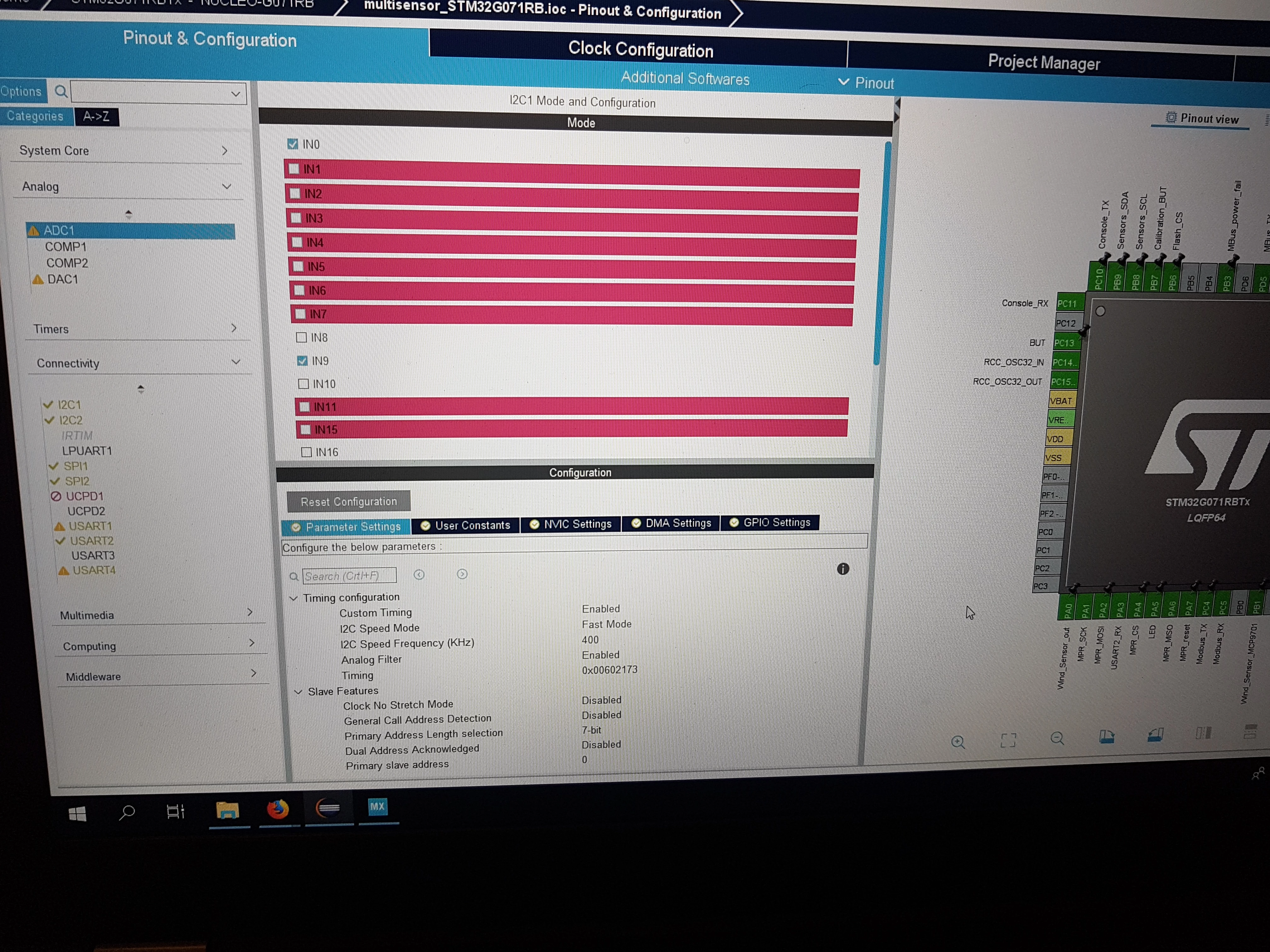

0690X0000088XwuQAE.jpgThe cube is a evident problem, You can see when you turn something into a problem with ADC. See I have ADC turned on and the configuration from I2C is displayed
