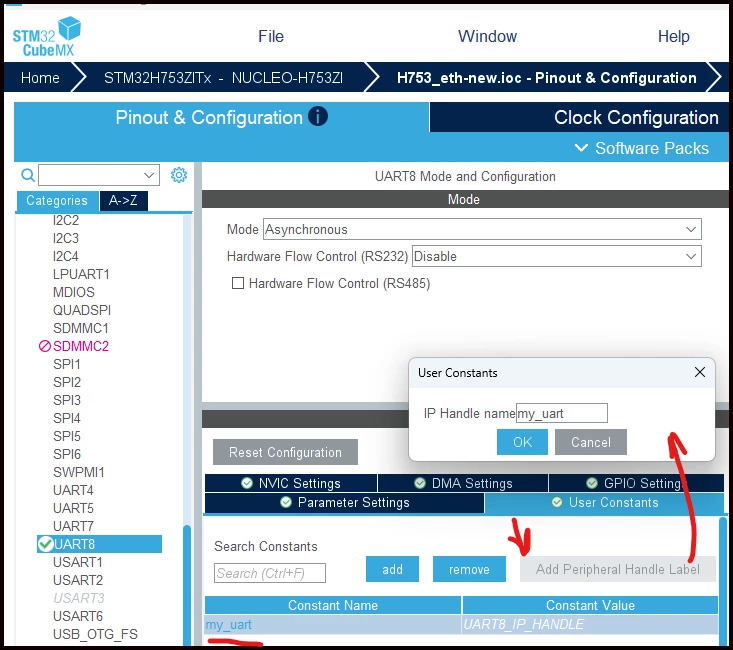

In CubeMX it looks like we can define a custom name via the “User Constants” tab ?
I’ve tried it for a UART but it does not seem to work: does not affect the generated code, even the #define is not added to main.h or uart.h.
In the ioc this adds the line: Mcu.UserConstants=my_uart,$$_UART8_IP_HANDLE_$$

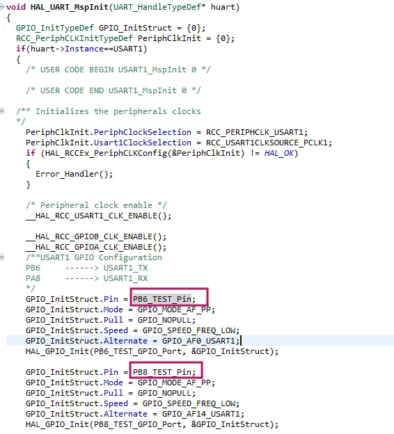

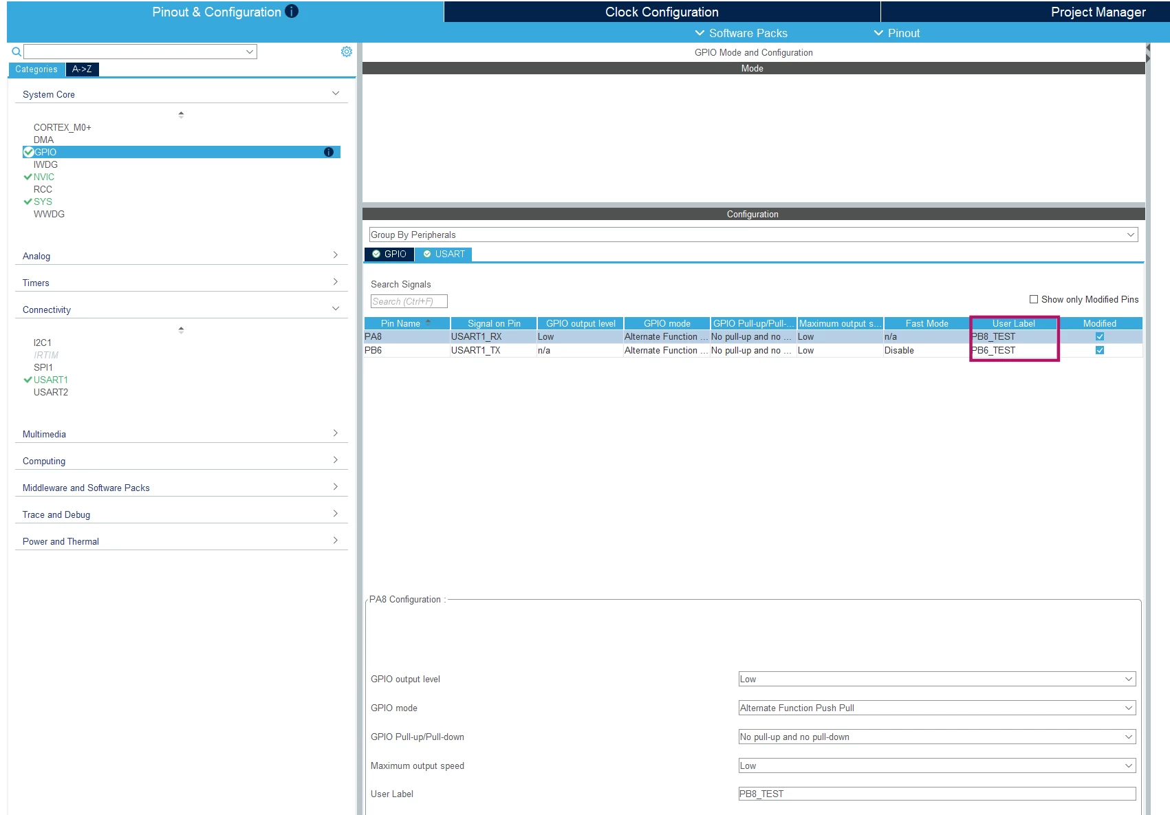

Sep 21, 2026 9:43 AM UTC
Hello ​@rgpb
Let me thank you for posting and welcome to the ST Community.
You are able to set the UART pins label through STM32CubeMX.
Thanks.
Mahmoud

Pavel A.Best answer
Oct 1, 2026 2:04 AM UTC
rgpbAuthor
Oct 1, 2026 7:50 AM UTC
Thank,
This solves my issue.
