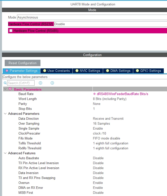

STM32CubeMX UART LL Driver issues
I had earlier raised the concern on STM32CubeH7 GitHub page ( https://github.com/STMicroelectronics/STM32CubeH7/issues/69 ). However they asked me to raise the concern on this forum.
I am observing following function calls missing from MX_UART8_Init() function, even when ClockPrescaler, FIFO Mode Disabled, etc. are defined:
UART_InitStruct.PrescalerValue = LL_USART_PRESCALER_DIV10;
LL_USART_SetTXFIFOThreshold(UART8, LL_USART_FIFOTHRESHOLD_1_8);
LL_USART_SetRXFIFOThreshold(UART8, LL_USART_FIFOTHRESHOLD_1_8);
LL_USART_DisableFIFO(UART8);
Please refer to attached snippet which shows settings used in STM32CubeMX.
Please help with a fix.

Does UART8 support those features?​

I am sure the FIFO Enable and Disable are supported.
I am sure TXFIFO and RXFIFO thresholds are supported.
The UART7 HAL driver does use Clock Divider and hence it must also be supported by UART8 LL Driver.

So CubeMX GUI allows options to be set for UART8
The LL code generator in CubeMX fails to output those specific options.
When you manually add the missing LL code in the project builds completely and functions as desired.​

Thanks for your post.The issue has been detected. I have raised your feedback internally to be reviewed and treated accordingly to the priority. We will give you an update as soon as possible.
