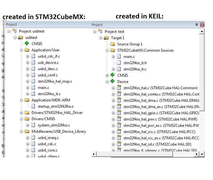

Sorry, I mean to say that when I create a project in KEIL Uvision and set-up the project as shown here: http://www.keil.com/pack/doc/STM32Cube/General/html/cubemx_proj.html
Than, if I add HAL drivers like I2C and SPI it works fine, but when I add Middleware(such as FATFS) it doesn't include the files in the project.
When creating a project in STM32CubeMX and than open this in KEIL, it works fine, only no possibility to use KEIL CMSIS drivers. I have shown the Keil environment in the screenshot below. USB middleware is added in both, but only the project created in STM32CubeMX has included all the files.
I hope it is clear now, thank you for your response.
