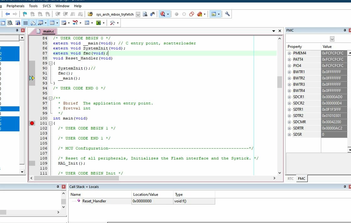

It is easy to access the STM32H753BIT6 internal SRAM and peripherals.
In the internal SRAM, one can easily create a global variable and simultaneously assign a value to it. Similarly one can easily declare a section of internal SRAM as UNINIT / NOINIT. However, this is not easy for an EXTERNAL SRAM that is configured using the FMC.
Also when an external SRAM is configured using the STM32CubeMX tool, the tool does not add section / address range associated with the External SRAM to the SCT file (which is used by Keil compiler).
Further, in order to allow the __main (library code part) to store zero to every byte of external SRAM (like it does to internal RAM and SRAM), the System Clock configuration, FMC / External SRAM associated pins configuration and FMC settings must be executed before executing __main.
As the __main is responsible for setting up stack and heap, hence when configuring clock, FMC pins, FMC settings etc. one cannot use code pieces that use variables.
Hence tweak to the startup related file, SCT file, Project settings etc are needed. These tweaks need to be made available through STM32CubeMX.

Since inside "startup_stm32h753xx.s" Reset_Handler is defined as WEAK, you can define a new startup sequence with HAL like the picture below that initializes external SDRAM .

Hello @Khouloud ZEMMELI​  , @Vangelis Fortounas​  ,
Is it possible for STM32CubeMX development team to provide:
1. A FMC Init code / driver (preferably LL DRIVER) which does not use variables.
2. If above is not possible then mark the FMC Init function as WEAK
3. Always update the SCT file with start address and size of EXTERNAL SRAM (connected over FMC)
Thanks,
Rajeev ​

Vangelis Fortounas
Apr 26, 2021 9:07 PM UTC
Hello @Rajeev Arora​
in startup_stm32h753xx.s line 239 Reset_Handler is weak so the programmer has the freedom to define his own Reset_Handler. (like the picture above)
I've coded few functions which do not use any local or global variable (except for various Microcontroller registers)
I believe these function calls and the Reset_Handler will help declare a global variable in External SRAM which can be assigned a value during declaration itself.
