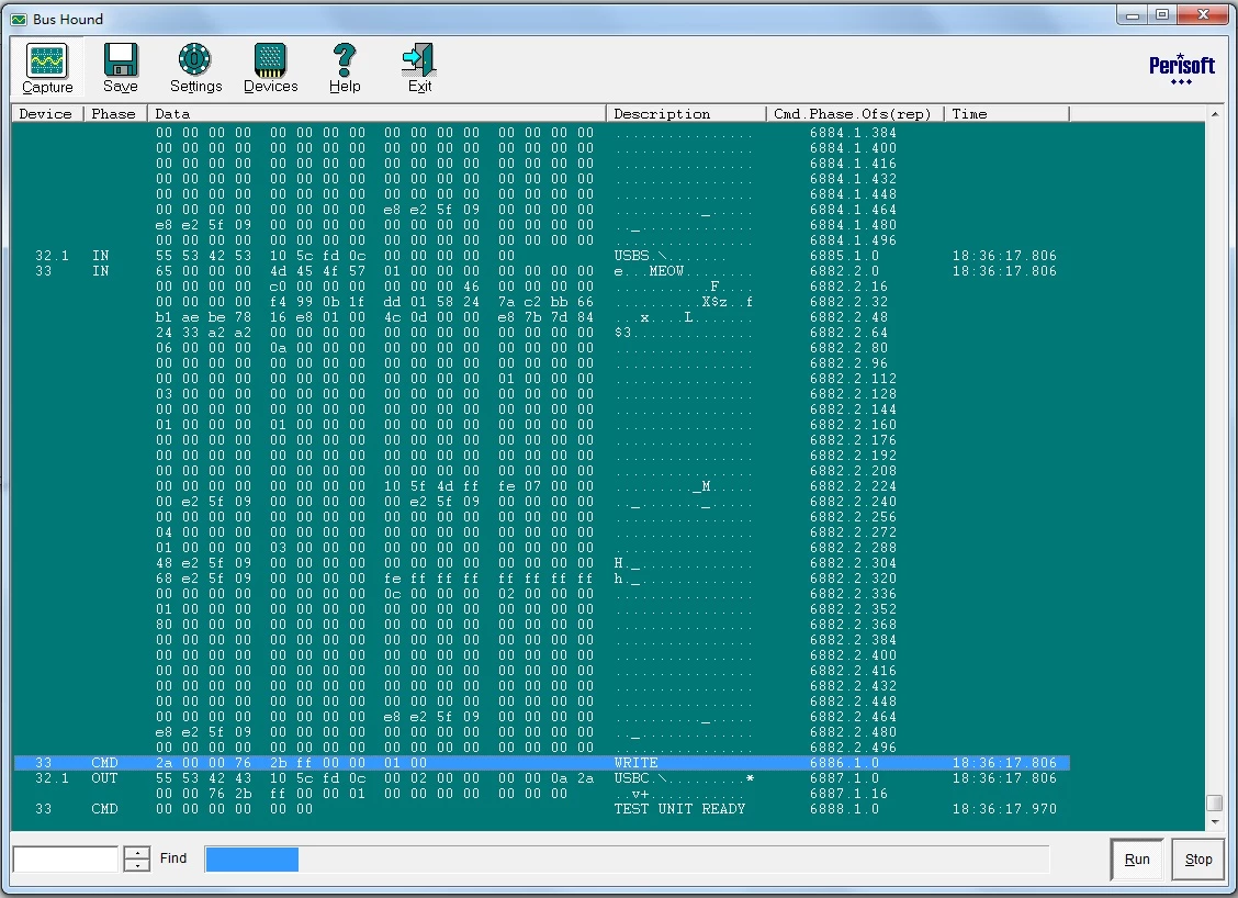

I don't know, right? The test Windows 7 is readable, written and formatted.
In usbd_msc_scsi.c file SCSI_Write10() function
Before:
  /* check if LBA address is in the right range */
  if(SCSI_CheckAddressRange(pdev, lun, hmsc->scsi_blk_addr,
               hmsc->scsi_blk_len) < 0)
   return -1; /* error */
Modified:
  if(SCSI_CheckAddressRange(pdev, lun, hmsc->scsi_blk_addr-1,
