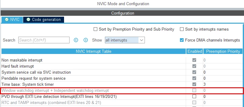

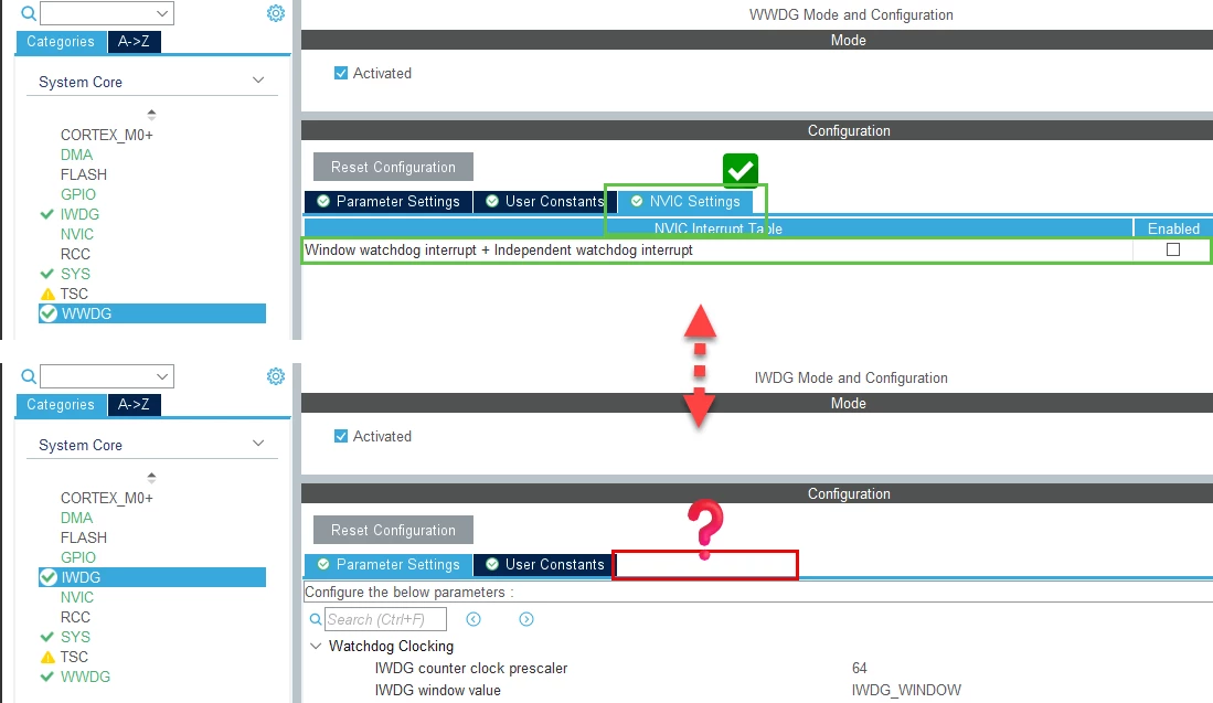

STM32CubeMX/STM32CubeU0 does not allow NVIC setting for singular use of IWDG
I like to configure IWDG (with early interrupt), but the UI in STM32CubeMX for IWDG lacks the NVIC settings tab compared to WWDG. I know that both units share the same ISR "WWDG_IWDG_IRQHandler", but why do I need to activate WWDG to get the Interrupt code generated? I really just like to use the IWDG due to its low power (stop 2) capabilities, I don't want the WWDG at all.
How can I activate the interrupt code generation for IWDG without activating WWDG?
Is this intentionally or is this a bug in STM32CubeU0 MCU package in STM32CubeMx?
ps. latest available versions installed (6.12.1 + STM32CubeU0 Firmware Package V1.1.0 / 05-June-2024)

October 9, 2024
I have not yet generated the code. I stumbled over the NVIC setting view in STM32CubeMX. When enabling solely IWDG, setting the values and selecting the IWDG early wakeup interrupt as you mentioned, still in the NVIC configuration, the respective NVIC interrupt is NOT selected and also not manually selectable as it is greyed out.
As said, when configuring the WWDG, NVIC allows checkmarking the interrupt.
I assume without the checkmark, also code is not generated for the IWDG early wakeup interrupt ISR. As said I have not yet generated code.

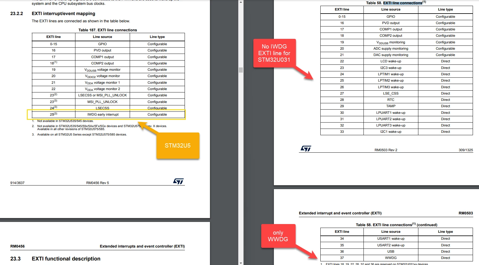

Hm,
I generated code - I started just with the watchdog functionality without entering Stop mode. But this does not work. The IWDG resets the MCU after reload value as expected, but the HAL_IWDG_EarlyWakeupCallback() is never fired.
You provided an STM32U5 example. Somehow I doubt that the STM32U031 can do that at all. I checked the STM32U5 reference manual and compared the table "EXTI line connections" to the one for STM32U031. And surprise: the IWDG is not listed at all for U031. This might explain, why STM32CubeMX does show it like this (assuming the datasheet is correct).
Maybe I just switch to use the LPTIM driven by LSI. I can achieve the same functionality I need with it. I am more interested in the Interrupt to call my application assert functions, than actually doing a MCU reset. Somehow the IWDG EWI gets a little bit useless in my eyes.

Hello again @chrislro,
Please let me clarify that the use case of U5 is not similar to U0, the need to enable the EXTI line in U5 4M/512k is to overcome the limitation present in U5 2M (ES0499 2.18.1)
Regarding the interrupt that's not firing, I was able to replicate the behavior on my side, so I submitted a ticket internally for further investigation (Ticket 193297).
I will keep you updated!
